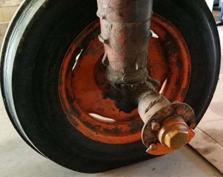

The left wheel broke off around the center lug area (WD45 Axle pic_2a).
The center of the rims lug area was still secured by one lug (WD45 Axle pic_1a), which I removed to fully remove the rim from the hub.
None of the 5 lugs were loose, the center rim steel fatigued.

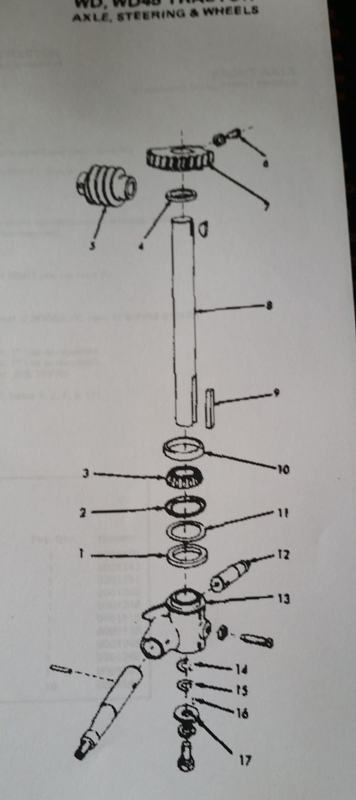

So I loosed the lower hex head screw (1-1/8" socket) on the #13 assembly and lowered the assembly off the #8 vertical shaft and removed the #9 key stock also.
I scrapped the crud off the support housing that contains the vertical shaft #8.
The broken pieces of the seal fell out along with the metal washer.
The #3 bearing is still on the #8 shaft.
I have about .100" left to right play on the #8 shaft and about that much when pushing the shaft up also.

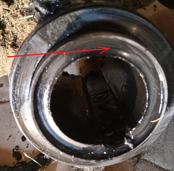

Does the mating surface of the #13 housing (WD45 Axle pic_3a, see RED arrow) look ok to reuse?

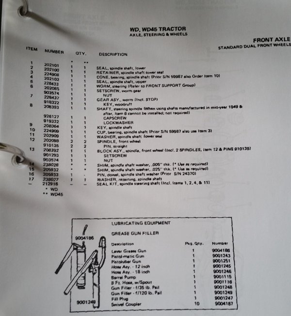

Ed, I notice at the bottom of the page there is a grease gun and a grease gun filler.  I wonder if these things are still available?  Or if someone has one?  I don't think I've ever seen a grease gun filler.......and I can't find any of the parts numbers in the AGCO parts Books.....

My shaft was wore down where he bearing preload was set too loose. I was able to get a machine shop to weld up the shaft and turn it down and thought I would go ahead and replace the bearing. At the time AGCO said the bearing was no longer available and the one bearing place I went to was unable to match it with anything. If that is still what you find out today be careful with trying to remove the old bearing as to not booger it up if a replacement is not available. Also remember the amount of slop in the pedestal may be due to not having the correct number of bearing preload shims in place. Let us know what you find.
