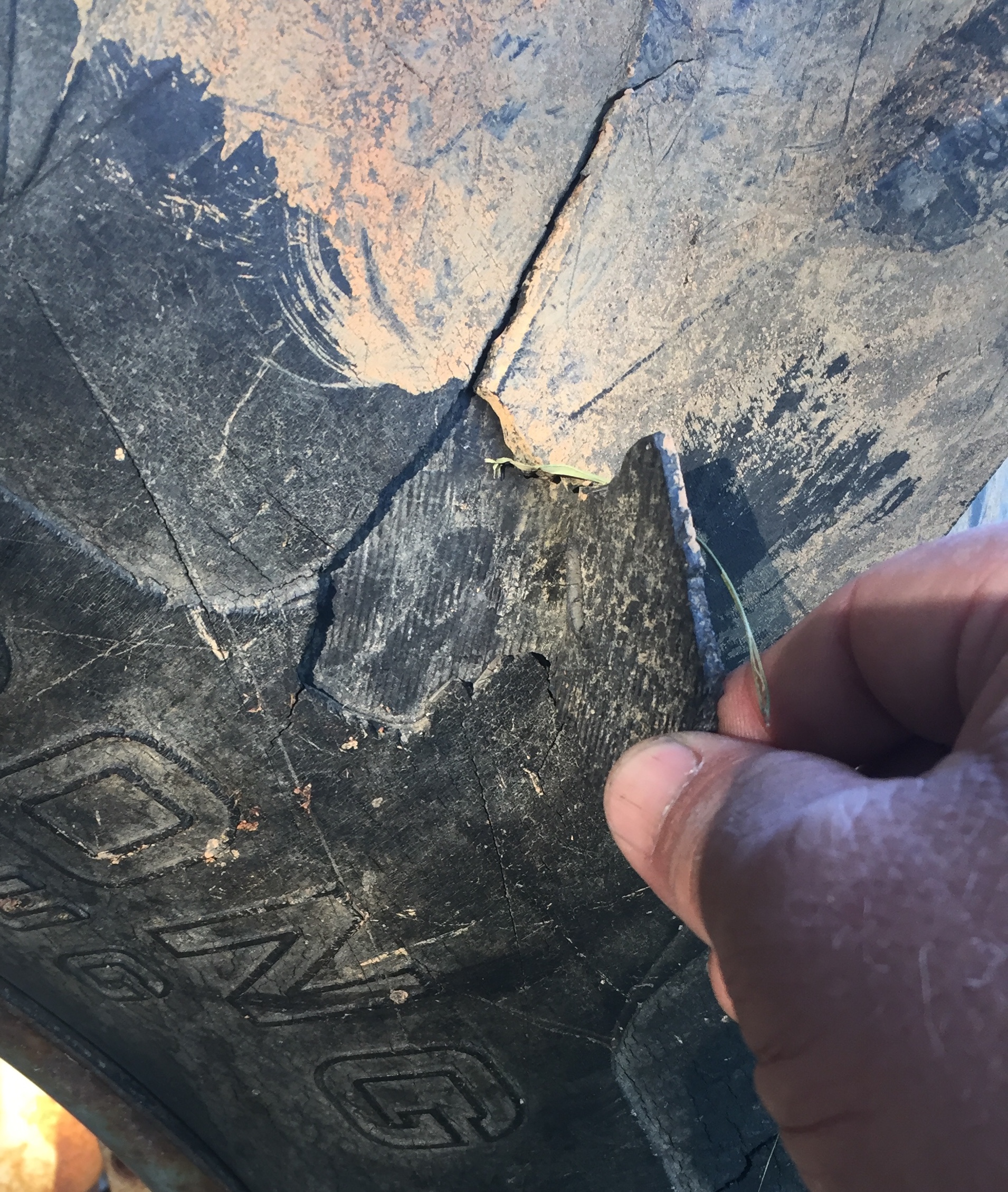

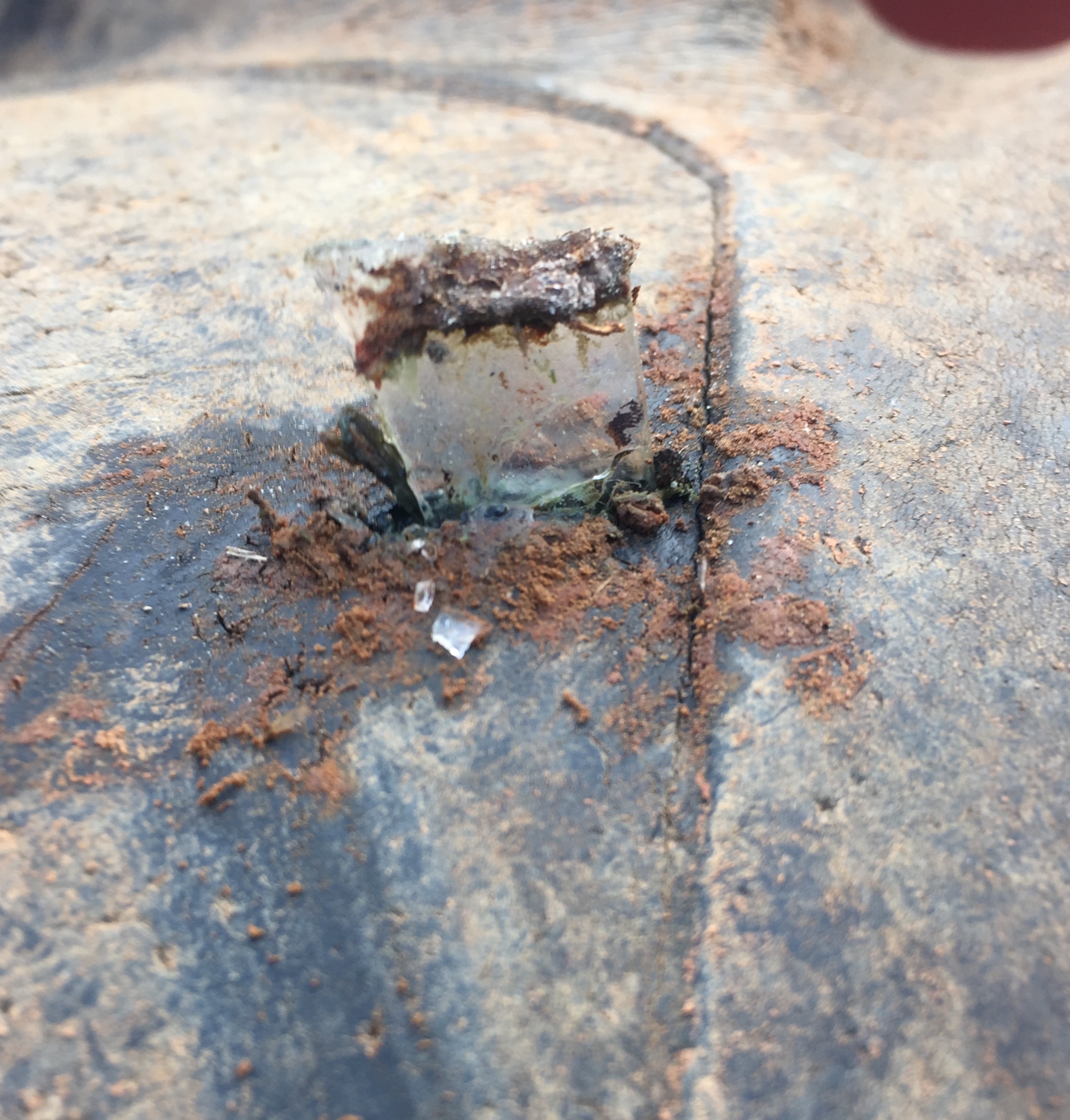

We used the 5040 yesterday to bush hog down the road. Found this little gem this afternoon. So I am in the market for some new rear tires. What brands do y’all recommend? I googled the tire size and it has Armstrong’s on it now but we use this tractor a lot and I don’t mind putting money into a nice set of tires as long as they will last.

OUCH.... but the tire looks like it has been dieing of a slow death prior to being POKED ?... Time for some new skins !.. Quite a few are made overseas in India or China these days.

I worked in a tire shop for a couple years as a kid. You can't beat the Firestone radial 23. If its a field tractor that's the best tire, but if it's a mowing tractor I would put a boot in the tire and just keep what you have on there. A lot of people will buy new tires for the mowing tractor and end up getting thorns and more garbage stuck in the tire. A new tires rubber is softer and soaks up the thorns/garbage where the older harder rubber deflects it. If you’re going to mow and need new tires I would go cheap heavy ply( that also helps with side wall flex in the ditches). This information is from 20 years ago, but hopefully it's still a little relevant for you. Make sure you specify your intent for the tractor when you’re at the tire shop.

This tractor is usually our “go to” tractor we use it with the 6’ bush hog and we either rake or Tedder hay with it . And we usually keep the yard tool on it to dress the riding ring at the horse barn. The tire casings have splits in them and I figured it was time for tires the cleats still look good but I don’t like the splits in the casings.

Red,. I sold a lot of both of those brands. I am wondering which Firestone he is pricing you that is cheaper than a Harvest King. Harvest King used to be made by Kelly. I worked with the H K tire engineers on a project. They had a good tire. If you decide to go with H K, get their 6 ply. If the bigger size is working for you, I'd stick with it. That split in the Armstrong is typical for them. It's time to replace them.
