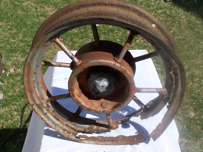

I have seen both Bs and Cs with the so called cut-offs on the front. Cut off the steel tire and weld on a rubber tire blank rim gives you a rubber tired steel spoked wheel. They did lots of rears the same way.

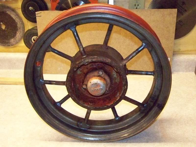

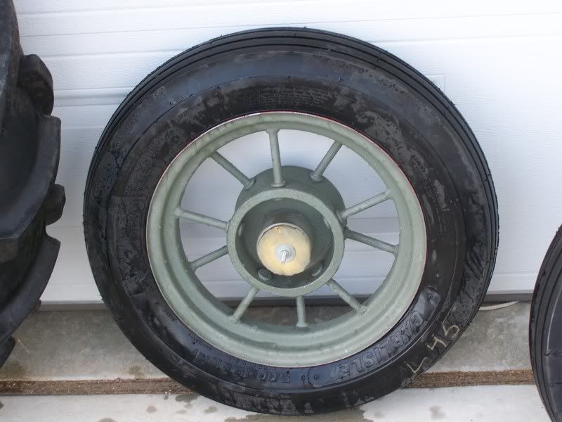

Yup, they're cutoffs. I've rebuilt a couple of sets with blanks from Miller tire. They're good as new and make nice looking front wheels on your B or C.

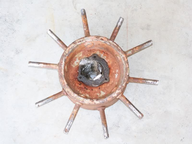

Post Options Post Options   Thanks (0) Thanks(0)   Quote Auntwayne Quote  Post ReplyReply Direct Link To This Post Posted: 26 Jul 2011 at 7:15pm
      Good pictures !!!
