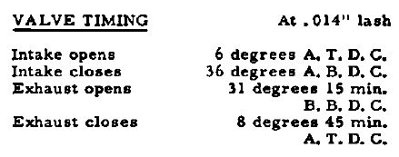

But, there is a way to get the low end torque. I called Howards Cams and told a tech guy what I wanted and told him to make a cam for me, using the basic Ford tractor, cam timing. I modified the timing slightly, based on a computer program but, you can give the cam maker, any timing you want and Howards, will make it for $135, shipped. That's what I paid for my Ford cam, a SBC would be the same price.
My suggestion is to do that and use the cam timing for what ever rpm you want, based on the original engine. The Fords have their max HP at 2200 rpm and the max torque is at 1300, I think.
For a WD, I would use the D17 cam timing, their max HP, is at 1650 rpm (WD's are 1300).
There is still a issue for tractor pulls. The rules that I run under, require a mechanical governor. If they don't require that, you can run a adjustable carb governor.
At a swap meet, I bought a yellow (Cat?) mech governor, to try and adapt. Not a easy thing to do.
This is the D17 timing, if you give this info, to them, they will plot the lobe profile for you, at no charge and you'll have a 1650 rpm, SBC with usable power.
