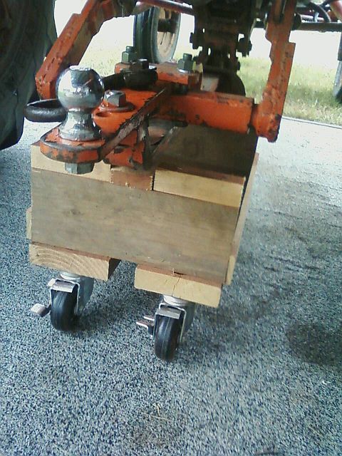

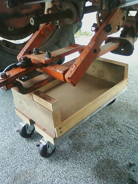

I was going to post pics of this to the thread a while back about all of us old geezers having trouble 'slinging' the drawbar into place on our tractors.  Didn't take me long to figure this one out and it sure has saved my back and arms, not to mention FINGERS!
It has a shelf where you can put the wrenches, pins etal. too.  I don't have a patent on it, so feel free to copy it.  LOL

Charlie, it works pretty good on dirt floors too.  That is a piece of outdoor carpet it is on.  Easier than laying on the ground getting dirt into every part of your body.  I have mostly sand and it works good.  Couldn't do it sitting anymore, got cramps almost every time I did it.  This suits me just fine!  Hardest part is lining up the holes for the pins.

Thanks for the idea Ted.  I have one of those Harbor Freight furniture dollys that I filled in the open center with a piece of 3/4" plywood to move heavy stuff around the shop.  It will be perfect to make a box to sit my CA drawbar on when I need to mount/dismount it.
