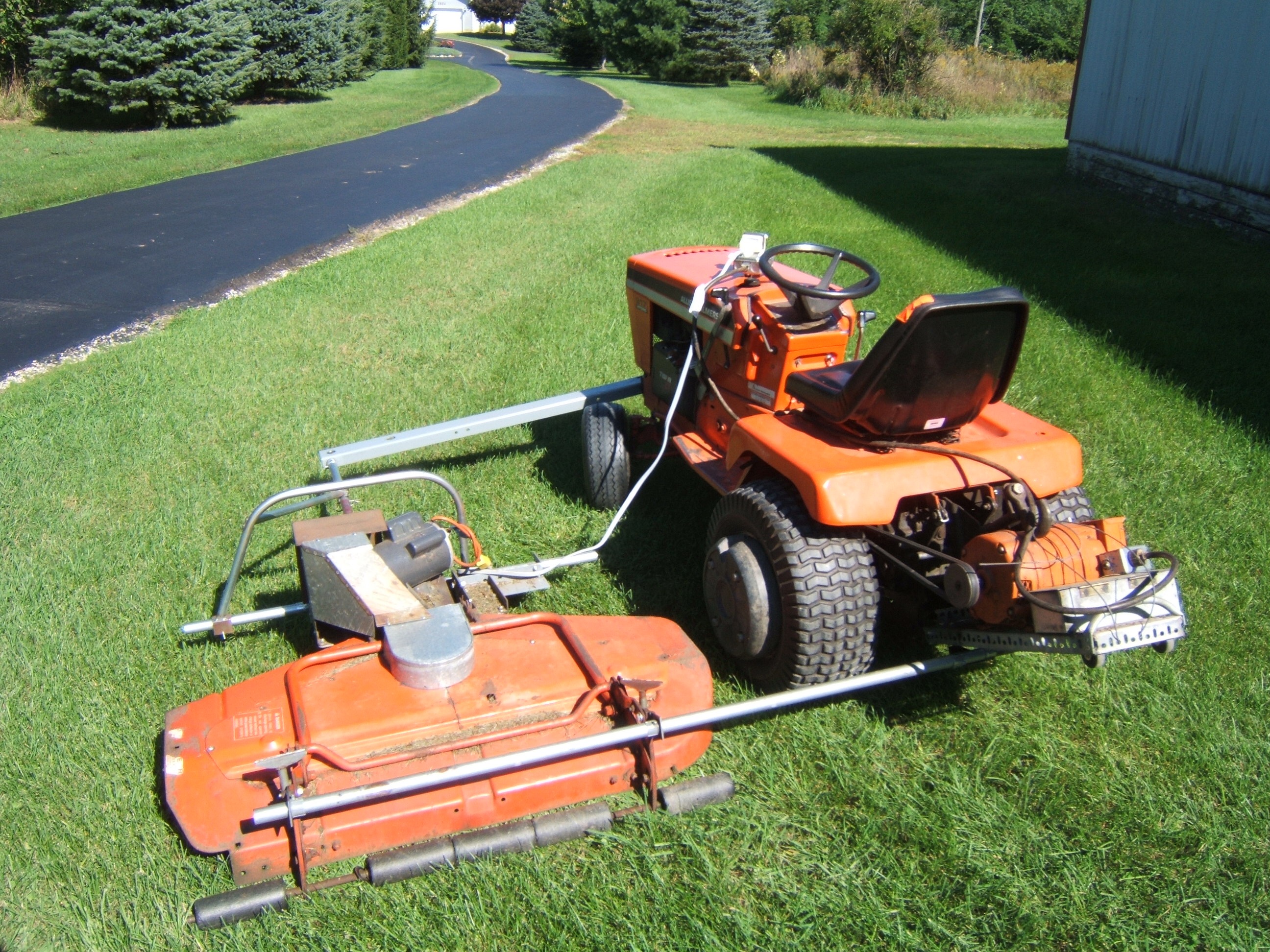

I call this my side winder.
I have a lot of pine trees with branches that hang down to the ground. this works real nice

oK, THAT'S NEAT !!!
NOW.... what's the specs on the electric  motor and genny and I asume the drive belt is twisted ??

Nice, a lot of innovation right there.  I would like one of those but I'm too old and lazy to make it.

Would be great for mowing the edge of ponds and close to ditches.

what HP is the electric motor ?... what is the mower deck width ?

The generator is a 4000 watt duel voltage 115/230 volt. Also a little different is a switch that allows a straight 115 v 4000 watt. It has a 120v 15a duplex and a 230v duplex and a 230v receptacle.
I forget the hp of the motor, but it's about all the generator can handle. I'm running it at 115v just because I had the electrical parts on hand, and I also use it to run other things at times.
Dusty
The deck is from my 917h garden tractor, 48", I've got 3 of those decks.

That is an awesome rig!! I think I’d use my sickle mower though. Already have all that stuff. Did you size the motor and generator accordingly or just guess?

I had the motor in stock, I wish it was a little larger, but the generator might start a bigger motor. It runs it Ok, but it has hands full starting it.
I have a volt meter I watch when I'm running the generator, which is really needed to know where to set the throttle.
