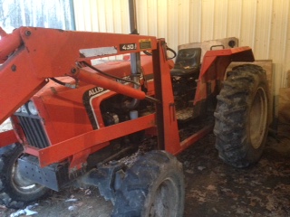

I have a 4wd 6140 with an engine problem I cannot fix. Looking to sell for salvage.

If you were closer id be highly intrested. That looks too good to salvage, and a matching loader with fwa. Hope someone could get it going

I don't want to scrap it. I used it regularly until last weekend when the engine noise started. I just can't find the engine parts to fix it.

I'm not exactly sure what parts I will need. It was running fine until last weekend. Then it stalled and now has a squeal in the engine then I crank it. It seems cam related . Engine seems to bind when one valve is in the down position. When I removed the rocker arm assembly it seemed to free up. So that's why I'm thinking cam bearing but I could be wrong.

The camshaft would still turn with the rocker arms removed, so I doubt it's cam bearings.

Do you have a way to manually cycle the valves to see if one may be bent for some reason?
