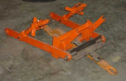

[QUOTE=ACinSC]On my old crusty D 15 I used a scotchbrite ? pad on my drill . Works pretty well . Think I bought it at home Depot . Also just put a new 3 point hitch on . Mine is a snap coupler though . Haven't tried it yet but it looks pretty robust Thanks[/QUOTE]
Where did you get the new 3 point hitch?
Can you share a photo?
If you would prefer, I have a different thread for the D15 3 point hitch replacement. That might be a better place for the comments and photo.

Got it from Jim at OK tractor . Dunno how to post a pic . Sorry

Does it resemble this? This was on OK Tractor website and was made by Cross Manufacturing in MO. It is one I'm looking at.
Seems to me it should have the same functional use as a factory 3 point.....but is stronger.

No , it's the wishbone? that slides in the snap coupler with the lift arms . It is a Cross .

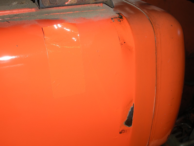

I flipped up the hood on the 1973 Allis 160. The paint on the fuel tank is covered by the hood and looks way different than the rest of the tractor. It is original paint, but I don't know how much the color has changed over the years.
So I just painted a piece of tape with Rustoleum Farm Equipment paint. Allis Chalmers orange #7458830. I placed the painted tape in the area of protected paint, took a picture. Picture taken in the shop, doors are open, no flash. The right side of the picture is the end of the tank, near your knees. This is exposed. it looks to me the exposed paint has faded darker and "dingier". We talk about cheap aftermarket paint fading to pink. There is no pink here. Also I "waxed" it all with WD40 to give the old paint some temporary gloss.

Post Options Post Options   Thanks (0) Thanks(0)   Quote BrianC Quote  Post ReplyReply Direct Link To This Post Posted: 11 Apr 2019 at 1:13pm
Yes, 1972 should be PO#2. But some say the Rustoleum spray is Corporate Orange.
My intent was just to show the relative color difference of 46 year old original paint to the Rustoleum spray can paint.
Cans of Tisco paint states PO1 or PO2 on the can.
I think the paint industry is a little dodgy.
