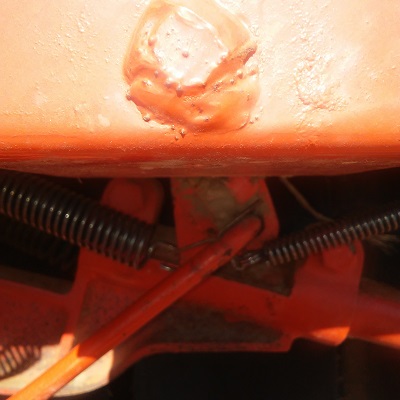

I got new springs from Agrimson,, there was a couple in question cause they were totally gone, and its kinda difficult to tell what goes where from the owner book..the first pic is on the twine arm

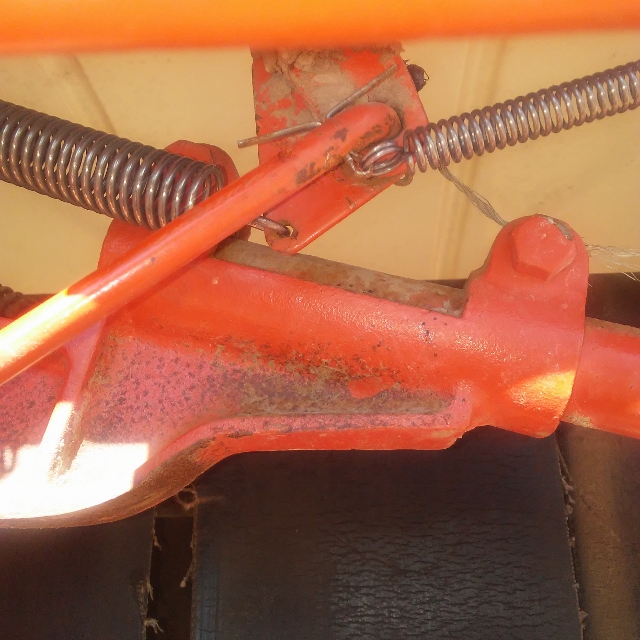

this pic of the trip lever/pickup drive

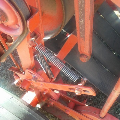

there are 5 springs the same and I think I have them all identified where they go
the small/really short compression spring goes on the brake band, but where do the other 2 compression springs go? their about 2 1/2" long and the same size diameter as the brake spring.

They go under the plungers in the arm of the roller. Adjust nut just enough to pull head into arm and slack out of spring.    MACK
