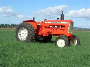

I have a 1961 D17 with a 262 diesel and I was wondering if anyone has or knows how hard it is to rebuild the roosa master fuel pump. The tractor runs but the fuel pump is leaking all over the place and has been for many years and now has just gotten to the point where I'm sick of loosing so much fuel. I know the seals are bad so if anyone has any idea or mabe knows where I could even get a rebuilt and send the core I would much appreciate it.
