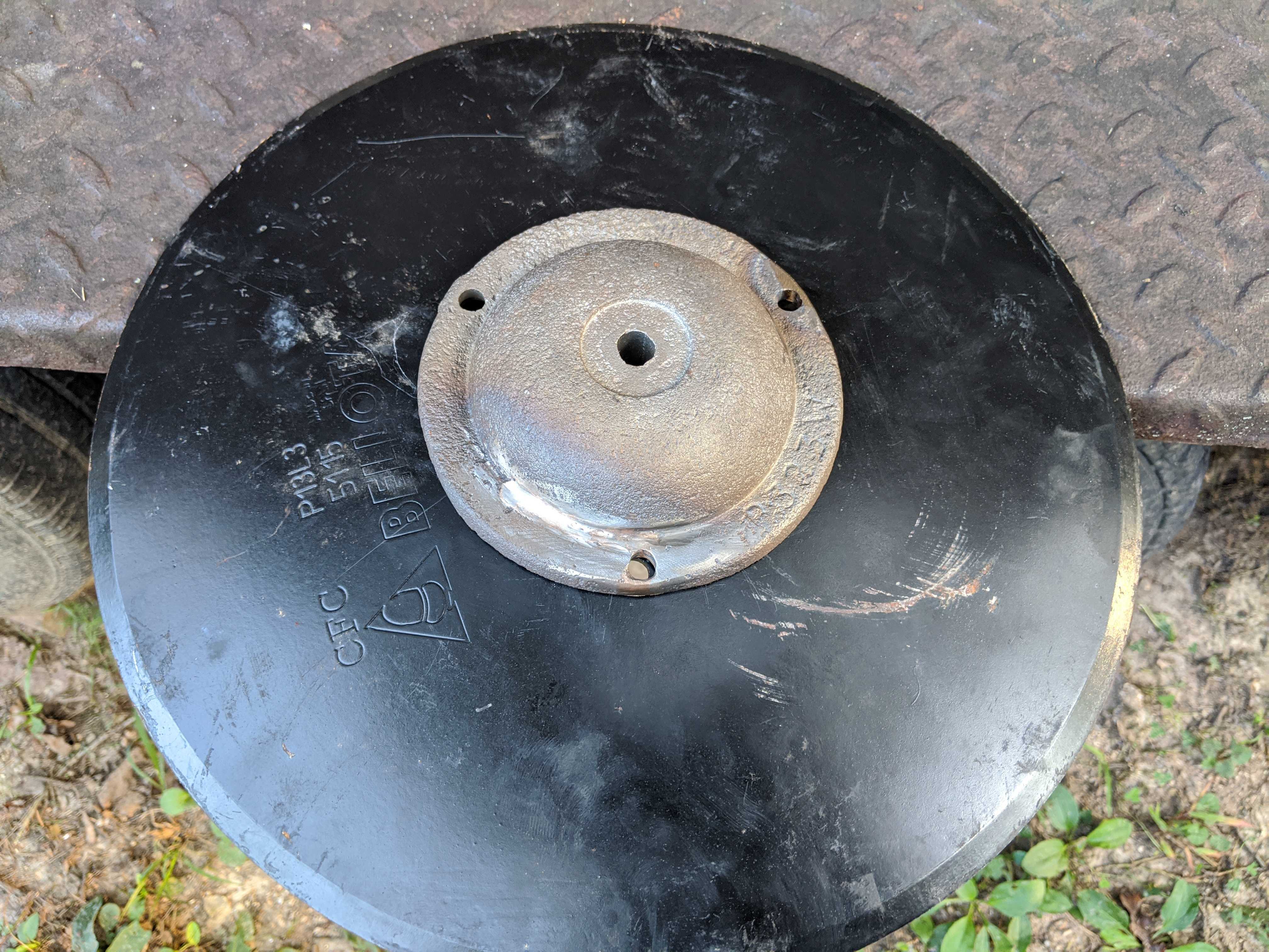

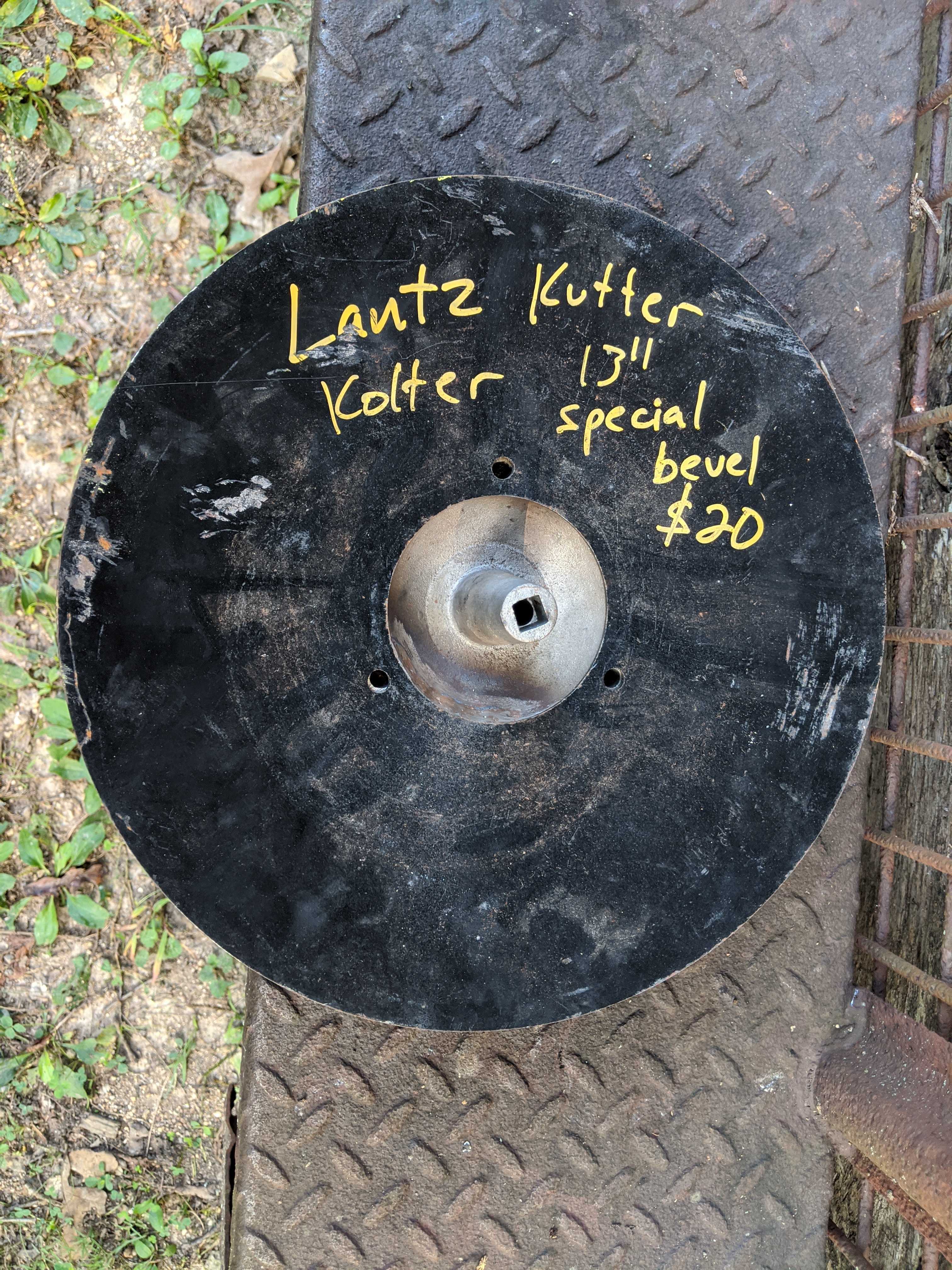

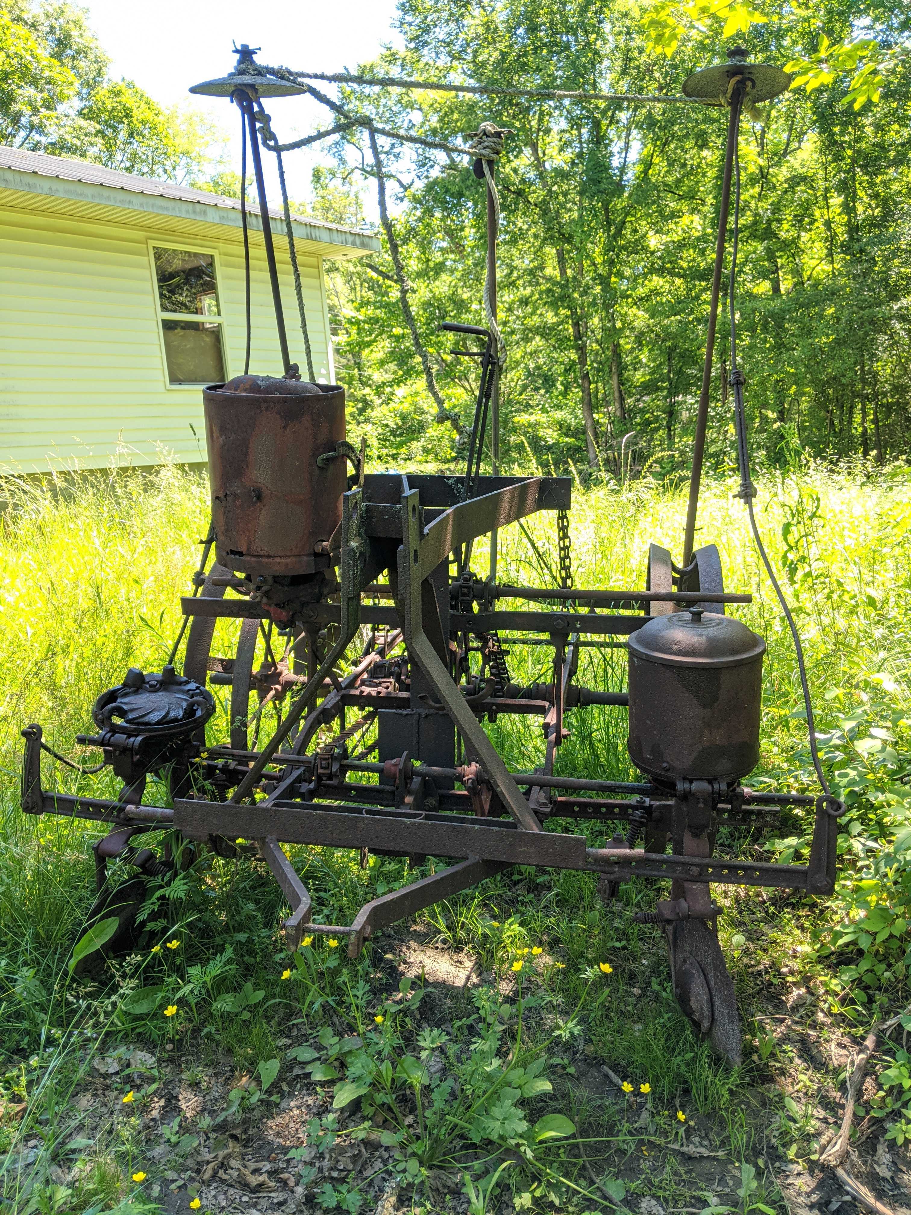

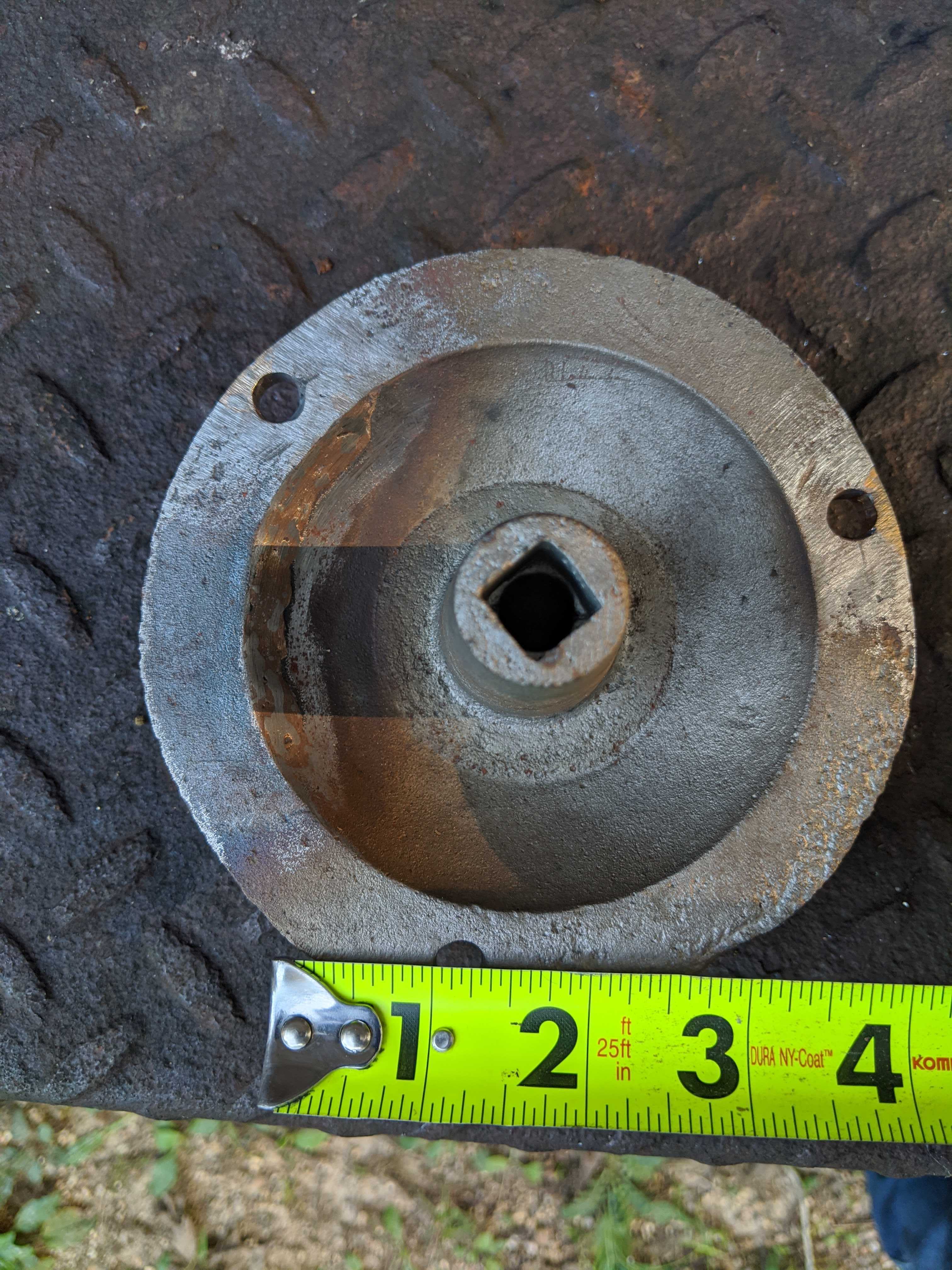

Recently I've been restoring an old horse drawn IH planter. The disc on the front were rusted out and I'm replacing them. The problem is, I can't find any rivets that are large enough to secure the new discs to the hub. I was hoping to get some advice on locating some.
It looks like the to rivets need to be 5/16".
Thanks ahead of time.
