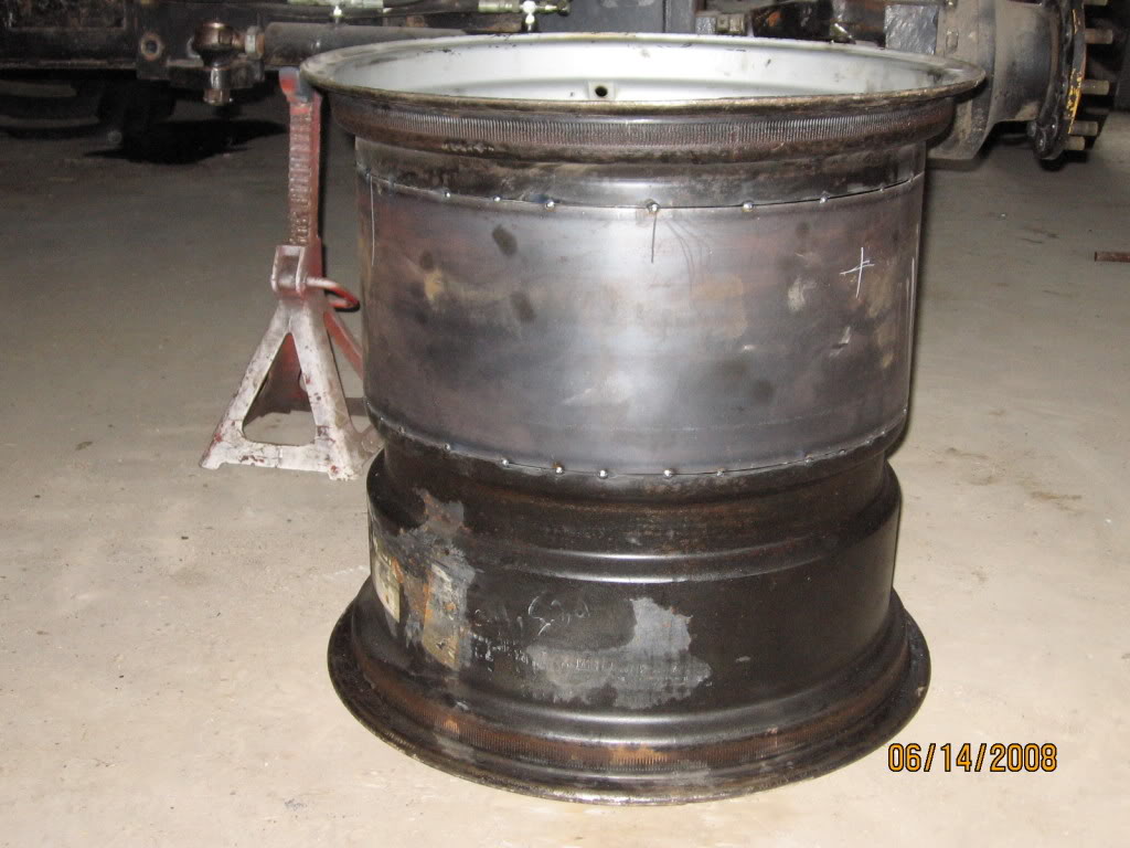

Post Options Post Options   Thanks (0) Thanks(0)   Quote leoversteeg11 Quote  Post ReplyReply Direct Link To This Post Posted: 29 Jan 2012 at 11:19am
Dick L View Drop Down
Location: Edon Ohio
Points: 5087
Post Options Post Options   Thanks (0) Thanks(0)   Quote Dick L Quote  Post ReplyReply Direct Link To This Post Posted: 29 Jan 2012 at 11:25am
That be a good picture of how it is done.
My Dad had that done to the wheels on his Oliver 77 in the 1950's when he was pulling. Not quite that wide.Smile He added two inches the same way on 38 inch rims.

This is what we did for our combine.We added 10 inches,from 18.4x26 to 28x26.The only thing I would say is tack everything in place, mount rim on tractor and spin it to see if it straight.You can keep stitch welding it in various places, but keep checkingit till your confident it's OK. Put a block of wood on the floor near the lip of the rim, and watch how much the gap changes as you are turning.Hard to get perfect but you wont be superstocking it, will you.LOL. When you cut the rim apart, try not to go too close to the lip;the more material you have on the small piece the straighter it will remain.We cut it with a plasma, lot colder cut than a torch. I am no expert, I watched/helped my brother, he is.HTH.
