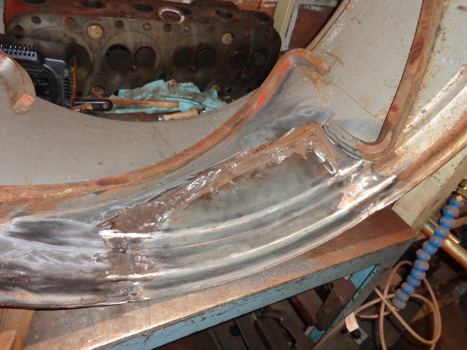

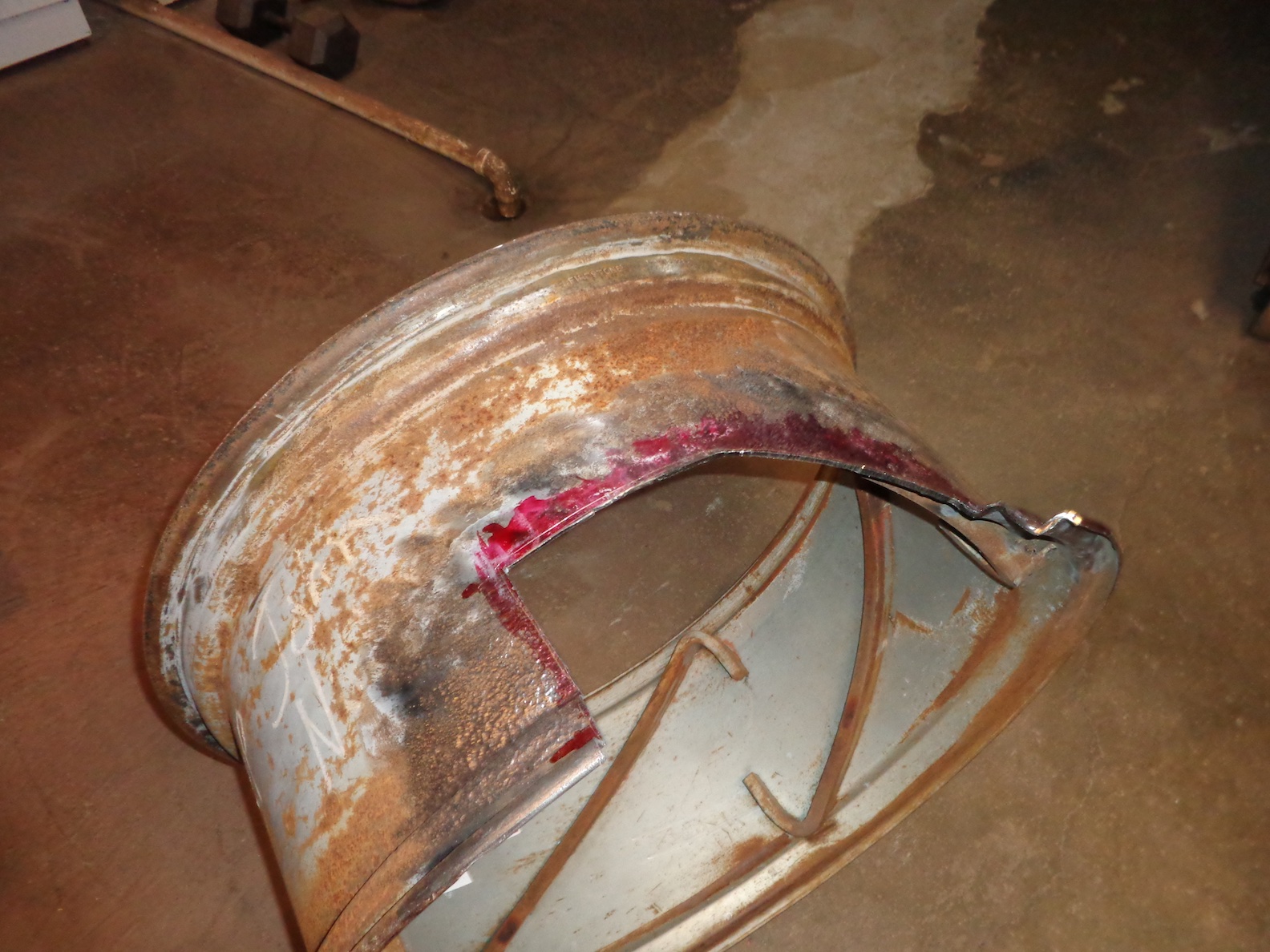

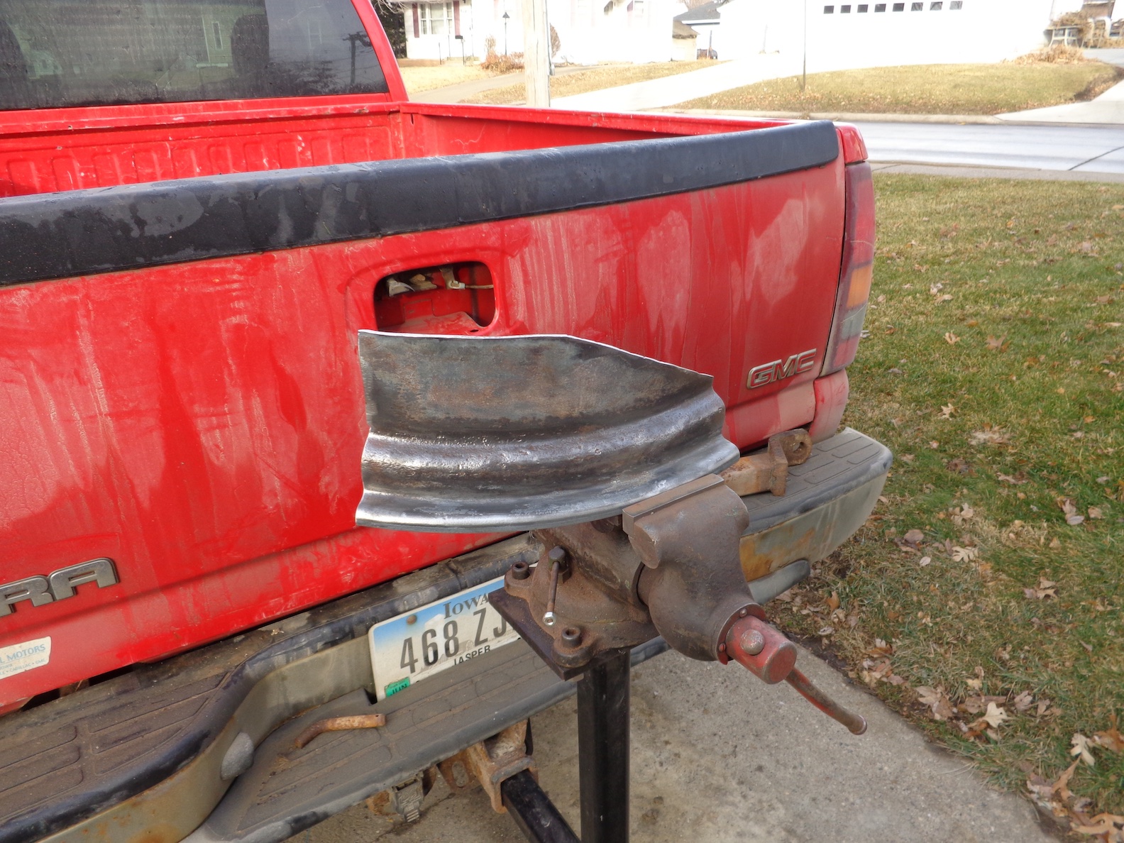

Last year I cut the rails out of a 13x28 spin out rim that was SHOT. I have a pair of rims I was going to weld them into. The other rim I have for donor rails is a 12", they are shorter than the 13's so I posted a wanted add on here and wound up with the 13x28 I needed for the project but when it got here I looked at it and decided it was too good to just cut up. It's really in pretty good shape other than the valve stem area. I have patches from some of the junkers I have scrapped so lets just fix this one and have a mate for the one 13x28 I already have.

Some of the progress shaping the patch and cutting out the damaged area. I spent a LOT of time fitting the patch to the hole trying to keep the welding to a minimum.

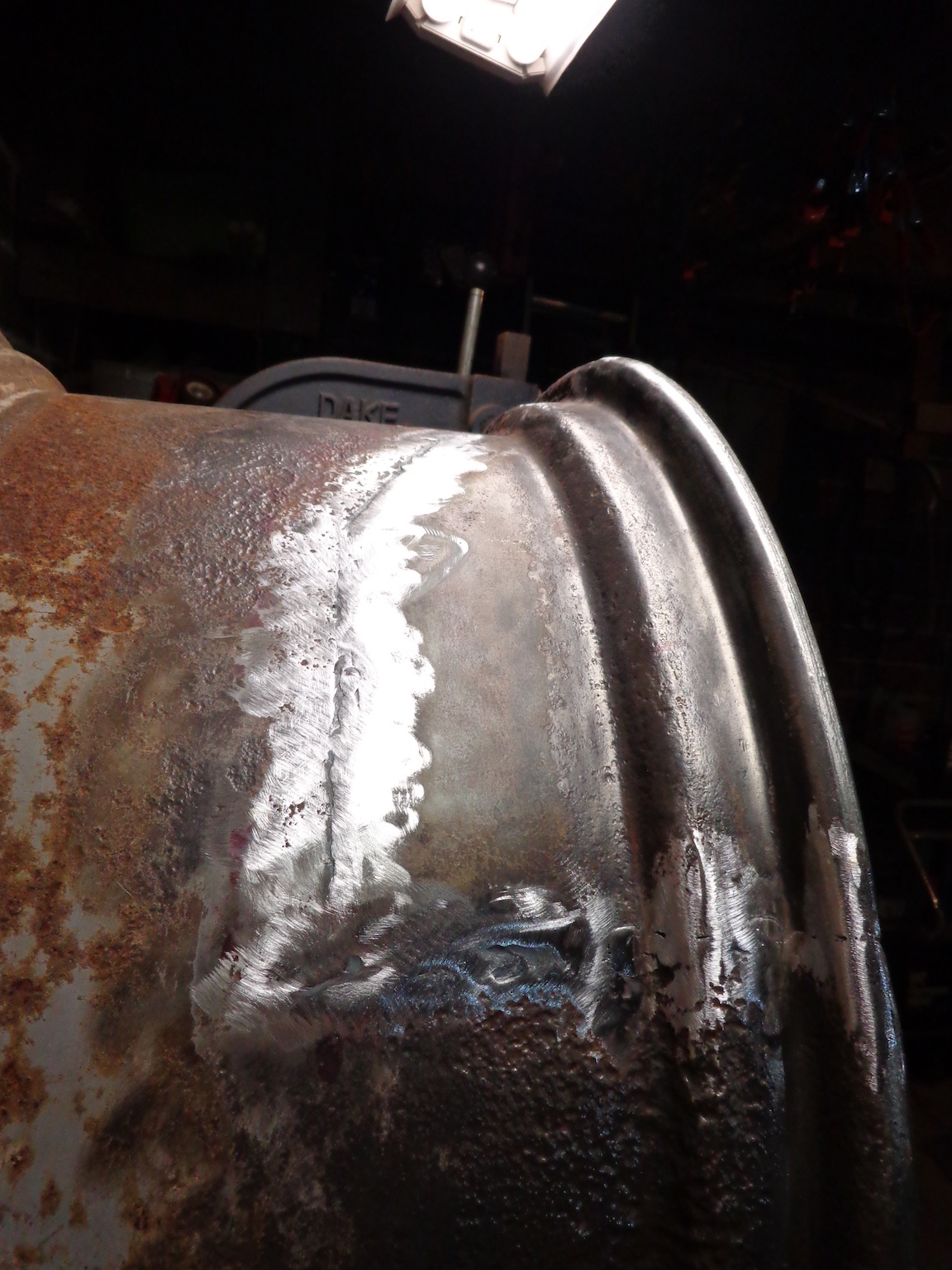

Yesterday I finished the welding, there were some thin spots that were a little tricky. Now just have to wait on mother nature. My plan is to heat up an area with the torch and hammer a flat for the valve stem, will practice on a junker before hand.

Mike,
 I think the repair looks very good. I have seen most of the rims that are on my project tractors have issues like this too. If I can save one I try. As you say most of the rim is pretty good! You did a very nice job fitting that new piece into the rim!
I did have a couple that went to be donor rims too.
I have never tried to weld on a set of rails. Were you going to do something special to get them in the right places? Not sure what the tolerances would be on the location of the rails? maybe +/- 1/16 inch??
I have tried the heating and reforming of the valve stem area too. The last ones I cut out a piece of angle iron and welded it in place. For some reason just was easier for me?? Not quite as pretty as a factory formed bump/ blister.
Looking forward to seeing the 16.9's on your 45 too! Should be a very nice combo.

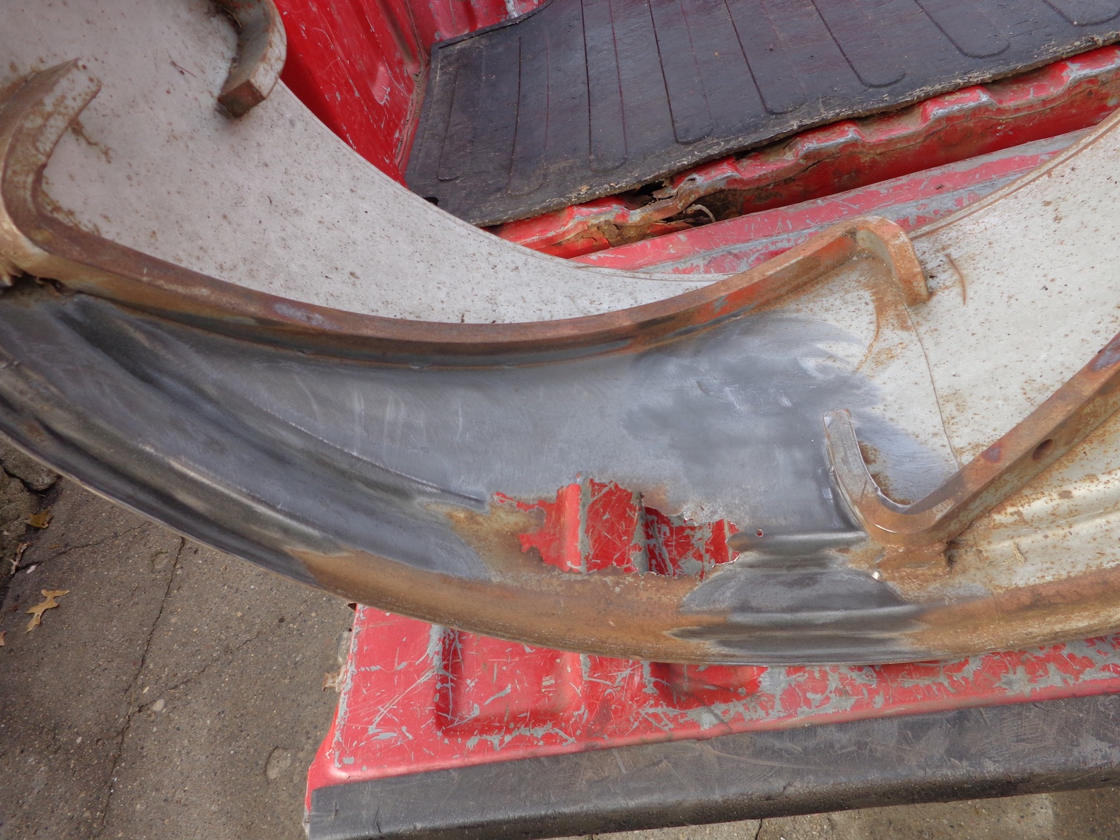

Here is one I started on, which looks just about like yours!
And the other one:
On this rim I forgot I had a donor piece that would have worked better than the 4 patches.
You did the right thing with the donor part!
Here was the valve stem area add on:
These were modified to 14 wide from 12's.

Real nice work!!
I like your portable vise support.......I've got an extra vise hangin' around doin' nuthin.....
I think I'll make one of those supports for myself!

Brian, that receiver hitch vice comes in handy. Really nice to keep the dust and dirt outside when you can.

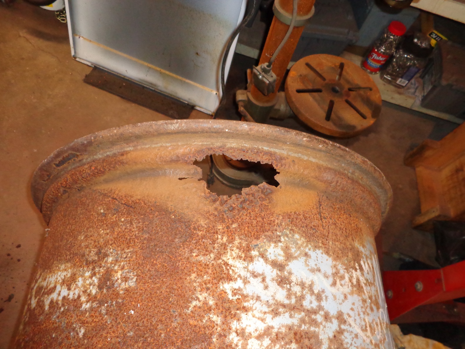

I need a piece to weld in. We don't have any donor rims to cut up. I kinda want to try to repair one
Mikez,
 You can do it. Having a donor rim may not be necessary, depending on the rust out area. I did not have one on the rims on my WD45. Sometimes just some 1/8 inch steel strip will provide the patch material. Really most of the work is getting the tire off, cleaning and prepping the area. Start a thread with some pictures of the bad rim. We will provide the couch support for you!:)

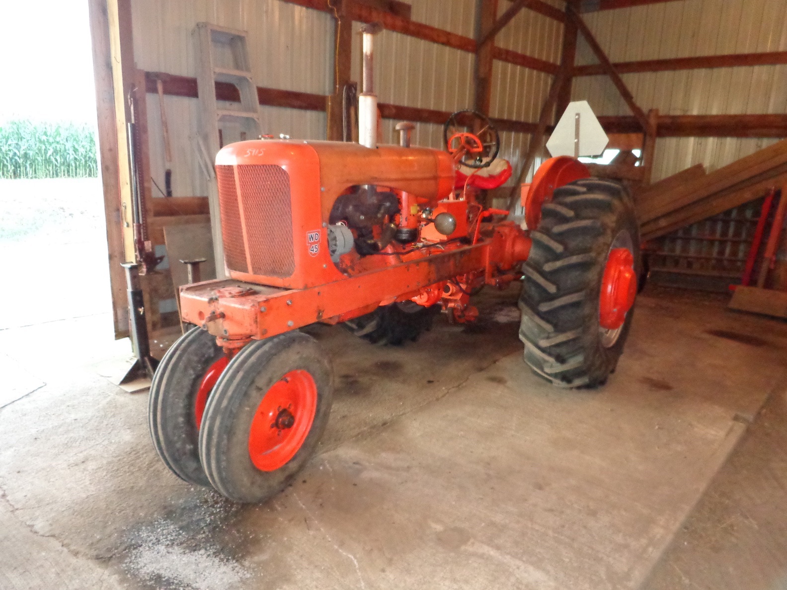

Chris, here is approximately what the tractor will look like when done. This the 'Wide-Front' when I redid the front end with a corn-picker pedestal. Wheel weights will be different. Also a shot of the tires headed for the 57. Recently got a broken bolt out of a spare manifold for that one, has a nasty exhaust leak. Really want to start making some progress on that old girl.

Mike,
 Those tires will look real good on any W series tractor! Your rim work and parts are going to look good! That's a good looking WD45 too. So that is the front end that can be easily changed to a wide front. I see it says 14.9-28 on 13 inch rim. I have some of my rims out at 14 inches. Think there is any down side to that? Side wall support issues?
