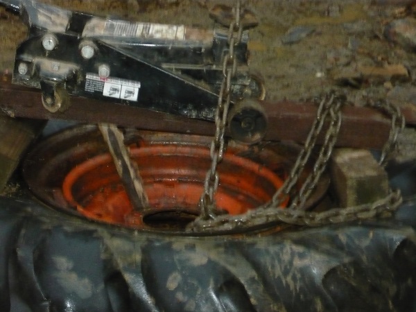

forgot to mention.  if tires are still on the tractor.   for the inside bead use a bottle jack and put against the tractor (what ever lines up that'll handle the load, I wouldn't use the pto or anything).  then just pump up the jack against the bead, might use a board between the jack and tire if it's a good tire.  for the outside I'd just take the wheel off and turn the wheel around so the other bead is on the inside of the tractor and repeat the above. hope this helps dt...

Originally posted by Driverdan Driverdan wrote:
Clever idea with Jack and chains to break bead!! However I do tire while still mounted on tractor, so may not work for me. I agree with WFOwner that it's not fun to pinch tube and redo all work to fix (been there, done that) but I disagree about bead breaking... that definitely is the worst part.. Dan
agree with ya, once the bead was broke the tires came off easy.  I took my tire, tube and wheel to my dads garage to have them put it on.  they had to inflate and deflate it 4-5 times and put lots of rim guard on to get the tire to seat right, it didn't want to center the rim on the tire?  glad I took it to him...lol
the last tire that was a @#$# to get off the rim, I used the jack and chain method to get a gap started at the bead, then used an air chisel to get the tire uncorroded (not sure that's a word) from the wheel.  don't think the jack and chain method would work for ya, gonna be hard to hold all that stuff in place.

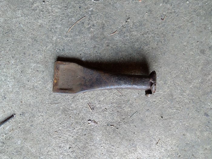

I first started hitting this tire wedge 50 years ago....
