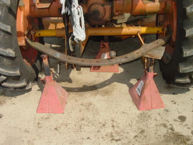

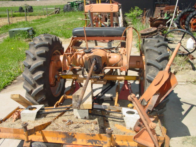

Post Options Post Options   Thanks (0) Thanks(0)   Quote Dick L Quote  Post ReplyReply Direct Link To This Post Posted: 27 Jun 2019 at 10:54am
Block or jack stands under the drawbar. Might take shims to keep it square with the torque tube.
Lift from the top of the engine to keep the front from flopping over.
Lift close to the gas tank to balance the torque tube to line up with the transmission.

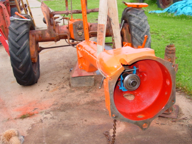

Dick L View Drop Down
Location: Edon Ohio
Points: 5093
Post Options Post Options   Thanks (0) Thanks(0)   Quote Dick L Quote  Post ReplyReply Direct Link To This Post Posted: 27 Jun 2019 at 6:22pm
Originally posted by frnkeore frnkeore wrote:
Are you bolting the torque tube, to the rear first or, are you stabbing the clutch with the torque tube attached to the engine?
I have assembled them both ways. With the torque tube attached to the engine and installing the drive shaft in from the transmission end. Also with the driveshaft installed in the torque tube and it cradled on an engine lift to attached to the transmission Then bolting up the engine to the torque tube as a normal engine install. It all depends on what all you have apart. I did the latter when all is on the floor in pieces. I did the latter on the one in the picture as I put in a drive shaft as well as a different torque tube
