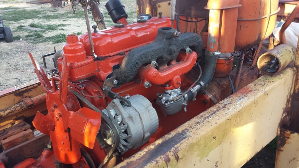

Well, I been putting in some time on the D14 Industrial and did get the new engine running great. Starts up like it supposed to.( Thanks to Dick L,,)!! Got some brackets made to mount an alternator. Cleaned up and re-mounted the air Intake oil bath system. Been cleaning up the gauges and managed to free up the ammeter gauge and the tachometer and they both seem to work great,, Got the radiator cleaned out, reverse flushed and lots of dirt blown out,,,dang no wonder thet thing was so heavy,,,!!!One of the pics I an posting is a 1/4" rod bout 37" long that was laying loose under the gas tank,,,was not hooked up to anything so maybe somebody can recognize it for me.
Somebody, a few says ago, was askin bout the oil cooler lines for the shuttle clutch goin to a separate cooler,,,I guess this one being an Industrial has the oil cooler built into the radiator

It is the choke rod for the Carb.

Hey Richard,,that's what I thought it might be too but it doesn't seem long enough,,,,,,I held the bent end by carb choke butterfly and the little plastic knob is bout 8" shy reachin the instrument quadrant. don't see where it might have been supported either,,,,???

Joe that is about the right place for the rod to end based on the one that was on my d17.   The instrument panel on the d17 has a support brace that hangs down there sort of like a triangle shaped opening behind the instrument panel and there was a little u shipped hanger there that held the choke cable you had to reach around the instrument panel to pull the choke rod.

   Thanks Dan,,,I'll give her another look-see in the morning,,,I bet I find a place for it,,tho
BUT,,,you oughta know me by now,,,,I can' leave things alone and not too hard to make some hangers and lengthen the rod where it is right by the quadrant,,,,maybe in it,,,!!!
