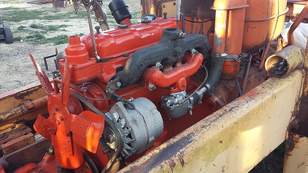

This may be a bit premature, but since I have started to get things together for the D14 Backhoe/Loader while waiting for parts or what ever on the D15 II.
I cobbed on to a good deal on an engine for the D14 which the Allis Express moved it halfway across the country to my home. YEA,,!!! Not being able to leave things alone for very long, I went ahead and opened it up for a look see. #1 and #4 looked great but #2 and #3 had some rust in the liners. Cleaned everything up and the rings look great and mike out from .007 to .008 end gap, so I may go with those rings. What kinda got my attention are the pistons. These are not like the piston/liner set I bought for the other engine several months ago, which have the dished top.
These pistons have a dome and the OD is 3.530 and definitely bigger than the other set I have. The block is stamped as a 149**** so,,,????
Can anybody identify them for me,??

OOOPS,,, pic did a Shameless and didn't load,,,tryin again,,,
pistons have GE380 on the pin boss and Confor-matic.
Piston OD. is 3.530

   some one has already been in this engine going what you have said--senn that brand used in WD,S ALSO HARD TOO FIND MORE

Never seen a piston head like that in an A-C. A standard "149" engine is 3 1/2" sleeve bore by 3 7/8" stroke. The series 2 "160" engine is 3 5/8" sleeve bore by 3 7/8" stroke. I assume yours is 3 9/16" sleeve bore by 3 7/8" stroke, making it a 154 cubic inch engine.

   Hey Dr. Allis,,,thanks for that info. 154,,Huh,,,? That's good,, that's good,,,,!! I'm going to go with these rings as the end gaps are within the Mfgrs. range. The 8 valves all held diesel from above but am gonna break em down and lap em a little just to be sure and re-assemble it and put a spark in it soon's I get a carb for it. Thanks for your help,,,

I thought higher compression pistons only had shallower craters but not domed. Domes are directly under the valves which is an interesting concept that I kinda like the idea of. That set the cogs spinning out of control. My engine funds does not support those kinda pictures dontchyaknow.

Looks like a pretty stupid design with a flat cylinder head. Your cylinder head is flat, right ?? because a true G149 and G160 really are flat. Older 115-125's are not. Not sure about the G138.

I am no enngine builder but I stood next to one while he fixed one in a Dodge that somebody had changed pistons and not enough valve to piston clearance. Only bent a few valves before it stopped the rotation during cranking.
Be careful, might be a reason that motor wasn't running...

Funny how that piston has the word FRONT engraved on it. That would be right or left, not front.

Joe here is what (might) have been in the mind of the person that designed the piston if it was for this engine, which I doubt. Not my thoughts personally.
This design puts the firing chamber around the outside of the cylinder rather than in the center.
When the piston is on the way down it creates a vacuum drawing the fuel mixture in. The fuel mixture flows in thru the valve seat 360º to the outside of the cylinder wall evenly without restrictions. After ignition with the piston on its way up and the exhaust valve open the exhaust is pushed out evenly with less restrictions. This would allow more air to pass through the engine for more HP.
This goes against the theory I have been taught that the crater firing chamber creates a swirl of the fuel mixture to give the most complete ignition. The firing chambers normally are crater whether it is in the head or piston.
This piston design would create a swirl as the mixture bounces off the cylinder wall. I am not sure if it would be equal to the crater swirl for ignition. My thoughts are it wouldn't but without test results I will keep an open mind.

   Hey DickL,,I did a little cruising on the web but only found the following.. The Pistons were made by Comformatic Piston Co for the Pow'r Seal Engine Kits of days gone by. They were built along the lines of the M&W Turbo Dome pistons. Couldn't find any more specifics,,but it is what it is,,as far as I'm concerned. I mike'd the piston to valve clearance and no interference issues there. Charging ON,,I say,,,,!!! Thanks for your help,,,

Well, I been putting in some time on the D14 Industrial and did get the new engine running great. Starts up like it supposed to.( Thanks to Dick L,,)!! Got some brackets made to mount an alternator. Cleaned up and re-mounted the air Intake oil bath system. Been cleaning up the gauges and managed to free up the ammeter gauge and the tachometer and they both seem to work great,, Got the radiator cleaned out, reverse flushed and lots of dirt blown out,,,dang no wonder thet thing was so heavy,,,!!!One of the pics I an posting is a 1/4" rod bout 37" long that was laying loose under the gas tank,,,was not hooked up to anything so maybe somebody can recognize it for me.
Somebody, a few says ago, was askin bout the oil cooler lines for the shuttle clutch goin to a separate cooler,,,I guess this one being an Industrial has the oil cooler built into the radiator
Posted By: Richardmo
Date Posted: 16 Feb 2016 at 7:09pm
It is the choke rod for the Carb.
Posted By: desertjoe
Date Posted: 16 Feb 2016 at 9:00pm
Hey Richard,,that's what I thought it might be too but it doesn't seem long enough,,,,,,I held the bent end by carb choke butterfly and the little plastic knob is bout 8" shy reachin the instrument quadrant. don't see where it might have been supported either,,,,???
Posted By: Dan73
Date Posted: 16 Feb 2016 at 9:08pm
Joe that is about the right place for the rod to end based on the one that was on my d17.   The instrument panel on the d17 has a support brace that hangs down there sort of like a triangle shaped opening behind the instrument panel and there was a little u shipped hanger there that held the choke cable you had to reach around the instrument panel to pull the choke rod.
Date Posted: 16 Feb 2016 at 9:26pm
   Thanks Dan,,,I'll give her another look-see in the morning,,,I bet I find a place for it,,tho
BUT,,,you oughta know me by now,,,,I can' leave things alone and not too hard to make some hangers and lengthen the rod where it is right by the quadrant,,,,maybe in it,,,!!!

   OK,,,got another one for the D14 Guru's,,,I cleaned up and painted the front wheels on the D14 yesterday and something's got me buggered. It seems the valve stem hole is on the WRONG side of the wheels,,,??? The "smooth" side of the wheels is opposite of the valve stem hole,,,,!!!! OR,,,,do the wheels mount on the tractor with the valve stem to the INSIDE,,,,???
Posted By: jaybmiller
Date Posted: 18 Feb 2016 at 10:50am
DJ
It's still too cold for me to vist the 'boys' BUT the wheels go on either way depending on the 'width' or 'track' or 'spread' you want to run the tractor on. That depends on crop spacing. I think there's 2" offset, so 4" overall. So you've got a 50-50 chance of the valve stems being outside as opposed to inside....

Well,,,we reached a big milestone with the D14 Industrial today,,,,,,It moved under it's OWN POWER today,,,,!!!!!!it hadn't moved in 20 something years,,,maybe 30,,,and it moved out pretty as you please,,,,!! Sure am glad I let ole Rick talk me into getting the right clutch disc ( like in lots more expensive),,,THANKS Rick,,,!!! The shuttle clutch worked so smooth in forward and reverse just as slick as owl chit,,,!!!! The push button on the handle kept hanging up,,,so we'll check out it's problems tomorrow...
I thought I was chitin in tall cotton,,,until the engine started to bog down and finally quit,,,,I could smell gas so I pulled the inlet hose from air filter to carb and lots of gasolins ran out,,,Gosh dang chit chicken chit son of a buck,,,!!!! If Mr shebler was close by,,I'd let him know where he could ram this POS carb up into,!!!
what's a man to do,,,???? and I was feelin SO GOOD,,!!!!!

I'm STILL having issues with the dang carb flooding tho,,, so I took it off AGAIN Grrrrr,,!!!! but I did find something odd,,,, the dang floats had collapsed inwards,,,,????Now,,what the hades caused that,,??? I had another carb off the B engine and is the same float,,but it was collapsed the same way,,,!!!!?????? what the hades????? Put em both in some gas and they WILL float,,,, but barely,,,?????
Fixin to call Rick see if he got one,,puzzling,,,for sure
Date Posted: 22 Feb 2016 at 5:07am
   "" the dang floats had collapsed inwards,,,,????""
Anybody got an idee on what caused the floats to do this? I got new one coming from Steiner but wanna know why so don't happen with new float,,,????
   These two floats I got WILL float but barely,,, could a guy heat em up and maybe they expand back out,,,,,thought blowin em up,,,?????

OK,,,I got 'nother one on the D14,,,,Yesterday before the carb went to floodin so bad,,,I tried the steering and I had to use BOTH hands to turn it,,,after so many tries back and forth,,,it got a little easier to the right but still takes two hands, and can't hardly turn it to the left,,,!!! Now,,bear in mind this tractor sat for several years,and still had bout half of the fluid in reservoir and looked like ATF.
Any suggestions from the group,,???
Posted By: Dan73
Date Posted: 23 Feb 2016 at 3:01pm
Blow up the front tires.... There is a chance you got a couple of the lines crossed to the control valve.   I remember reading about that a while back. I would be more concerned that it is a problem with the pump though sounds alot like when I run out of oil in my d15. Not sure if there is a good place to test the pressure in that setup but you need to figure out if the lines to the control valve are correct and then if the pump is working.
