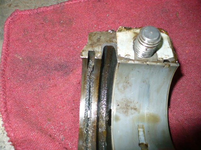

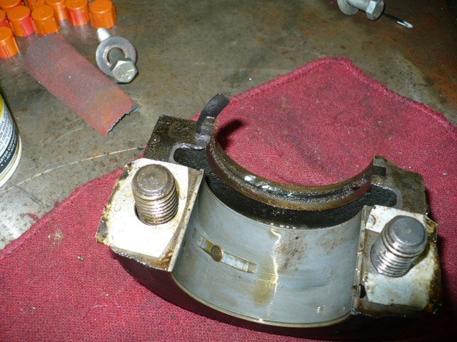

This is why I say to glue the rear main seals in, I know a lot you guys don't and have got away with it, I'm just saying it might spin at sometime and the oil will start coming out behind the flywheel cover on a WD/WD45.

Clocking them off from the parting line is an old trick to keep them from leaking (as much lol!)

ED you are right about some seals where installed offset but I was trying to show the seal as been pulled apart and it now now a three piece seal and the center part has spun to a diff angle in the main cap and top seal holder.
Sorry Dick I missed that post on the B/C/CA rear main seal, I was just showing this seal that was in a WD and you are spot on they are not the same type of seal.
