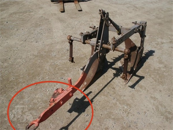

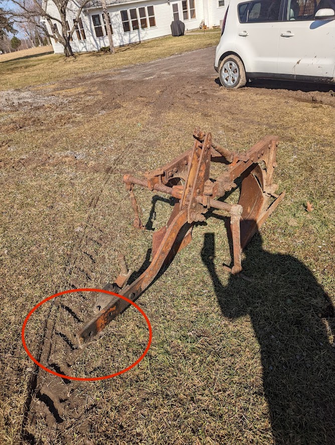

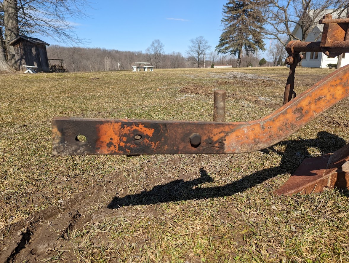

Hello all -
I'm new to Allis Chalmers, and their Snap Coupler system. I just got a D12 and a 2 bottom plow, the plow is missing the (drawbar?) on the front for the snap coupler. Online all I can find are flat ones that are used for hitching a trailer. The one I need looks like the eye is turned 90 degrees from the implement. I've attached photos of a plow with it, then the plow I have without it on.
Where do I find this? What is it called? Any help is welcome!

Someone HAS to have one 'laying around' for you...
Meanwhile, pour a lot of oil on the 'beaming screw' and pivoty areas to loosen it up !
If it's nice out, get a small angle grinder with '60 grit flap wheel' and shine up the frog and moldboards. A shiny plow is a happy plow....!!!

so, you don't have an Allis-Chalmers forklift yet ????

Hahaha no, no I do not!  Just the D12 at the moment, the forklift in the picture is just one I found online for reference to the part I need.  The D12 came with the plow and a brush hog.  I'm sure a forklift would be very useful in the near future as I grow the farm!

We always called it a snap coupler eye. Worst case scenario you can take some re-bar, and heat and bend to a u shape, weld to a flat plate of steel, same size as the plow's tongue.  Tricky part is getting the length right.  Back up to the plow, make sure that the lift arms are flipped once over, and are straight vertical, and make your measurements...Wink

Just a note; The eye that is circled in the picture is actually too long for that plow, not sure what it came off of originally but not that plow. Upshot, there are precious few like that out there. Piles of the correct ones, Lon or Dave the plowman can fix you up for sure.

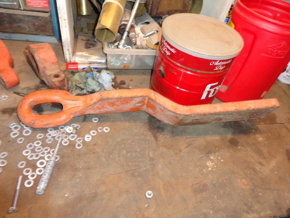

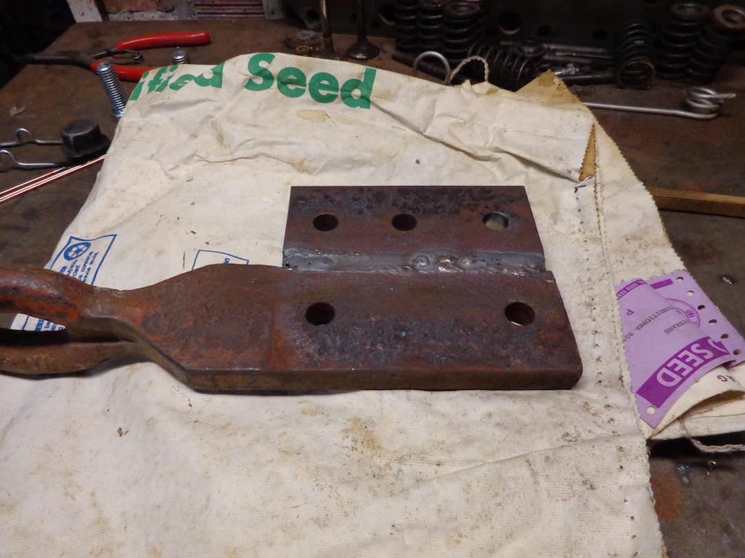

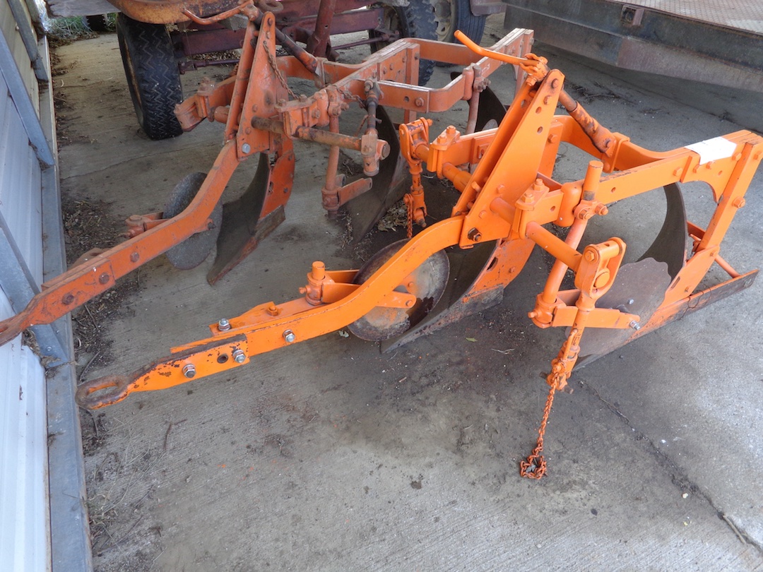

I'll post a couple of pics of what you're looking for. One is a modified one I did for my No. 4 Sub-soiler. The other is on a 52 plow. Guess there is one on a 53 plow in that shot too.

As to the safety aspect a few things to look at; you're plow has the correct 'lift links' on it. A lot of problems came about when pin-coupler plows were 'converted' to snap-coupler. I.E. they bolted the eye on and went to the field. The original links couldn't release from the lift arms, if an obstruction was struck the plow would spin up and strike the operator, bad deal. Sadly I know a gentleman, (who should know better) that plows with a set-up like this. I just cringe when I see this at a plow day.
Other things to look at; Spring in the 'bell', and just overall slop. When you step on the drawbar, how much does it move? Less is better.
I've hit some pretty good rocks plowing, good enough to kick the hand-clutch out and snagged a couple of tree roots while sub-soiling that stopped the tractor dead. Never had anything uncouple.

That first picture I think is from one of the older plow that has the cultor attached to the tongue. That plow is missing the cultors. I'm guessing the longer 21 eye is longer to get the coultor away from the bell??? Id that bracket was too close it would hit

Never mind about that theory, I just ran out in the rain to look at an older plow that I got last summer but never used. It has the colture attached to the tongue and the standard eye.
