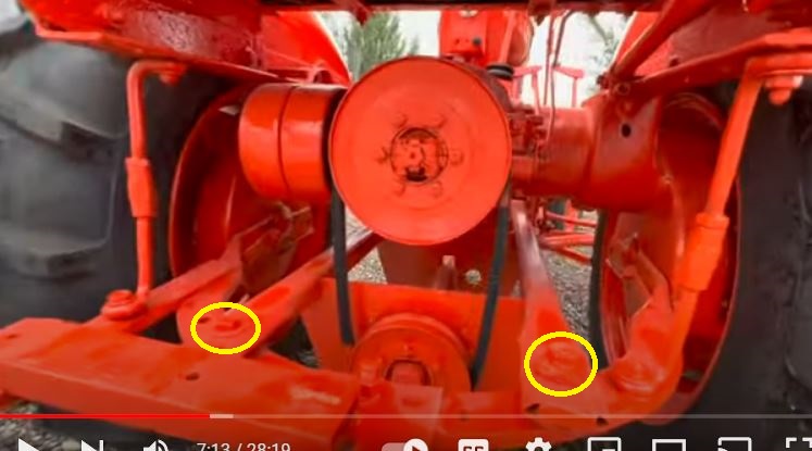

You have the Big "C" drawbar with two brackets attaching it up to the seat frame, right ?  Here are the two bolts that hold the mower to the drawbar...  You will need the pulley for the PTO shaft.... front end just hangs from the bell housing..

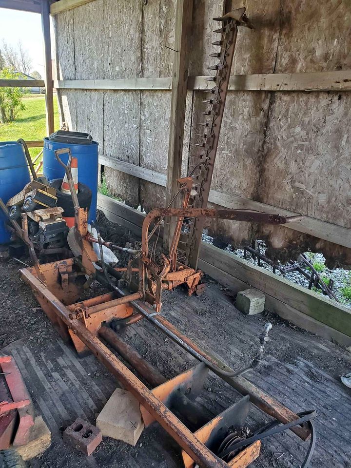

Here is pic of mower from ad. I cant tell if its a BC or no5 but maybe one of you can?Product photo of Allis Charmer cycle bar mower

looks like a #5... curved front hangers and 2 belts on the back..
