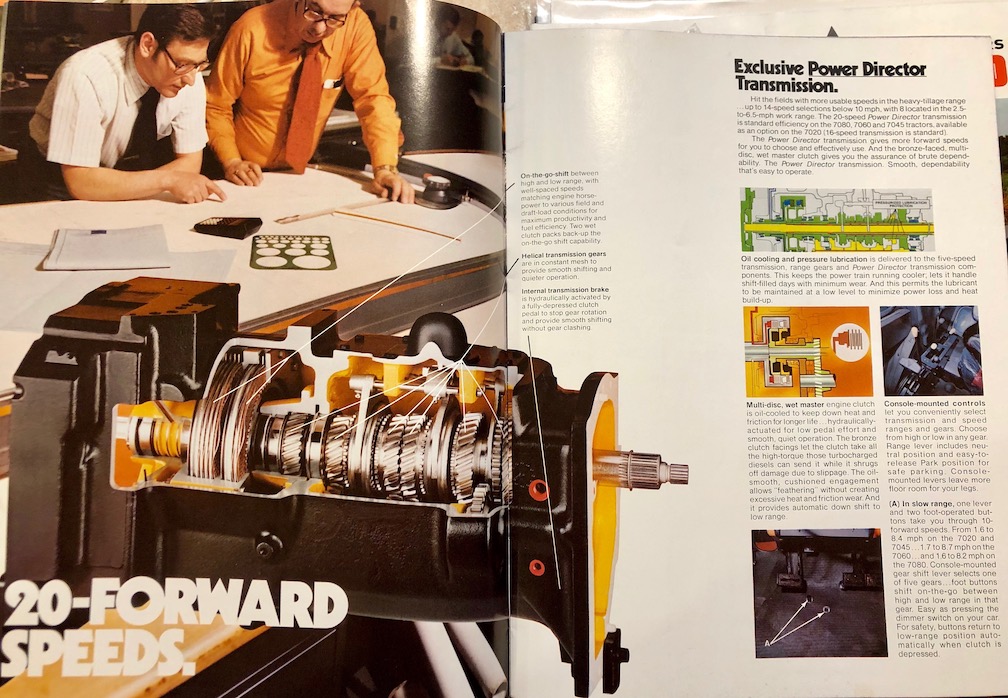

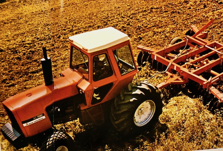

Per Mack's prior statement, earlier versions, 7000 series (7040,7060,7080)Maroon Belly, were built 1974-1977. These had their Power Director 20 speed trans gear shift in the floor, under the dash. Heres a photo of the 7080 series maroon belly tractor exterior. Notice how their cab's front lower cultivator-view windows have a protruding metal brow that mimics the hood angle. The later black belly 7000 series lost that cab brow & have a flat front of cab. Lower windows are still there but front of cab frame is straight up/down.
These early 7000 series transmission gear shift was located under the dash in the floor. Only their Hi/Lo range shifter was located in the side console.

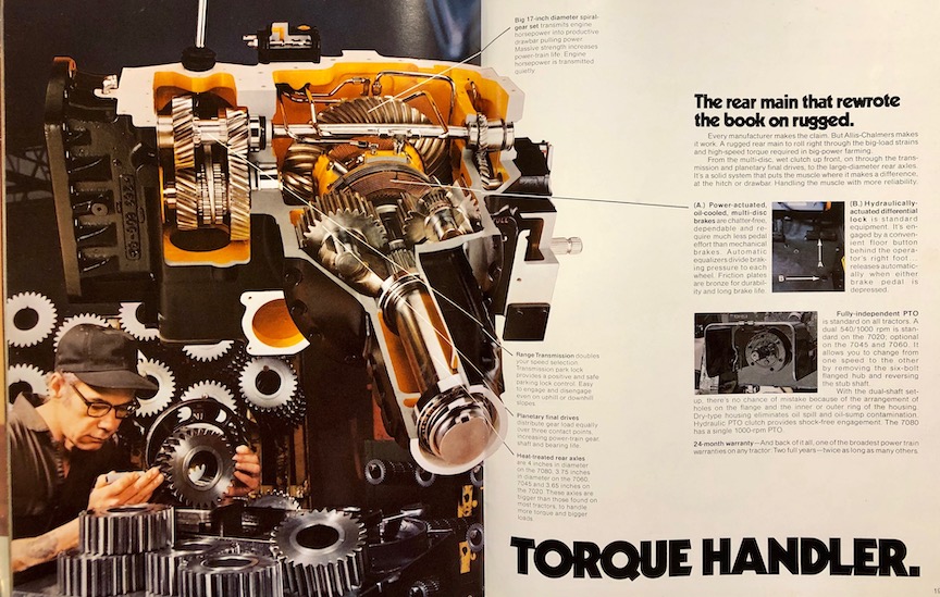

Your later version, Black Belly 7060 should have a "T"handle for gear shifting its Power Director 20 speed transmission. Unlike the earlier maroon belly models, the later built black belly models moved the gear shift from under the dash, over into their side console. Heres a picture of black belly trans cutaway with a small side insert photo of t-handle. Sorry, it's not a very clear insert photo of t-handle. Anyway the Hi/Lo range shift lever is located on the right side of T-handle gear shift lever in the side console.
Second picture shows your Hi/Lo range cutaway positioned in front of tractor's rear differential. Please note that both the T-handle & Hi/Lo shift levers used metal flex cables incased within a tough plastic flex housing. Over decades these cables become worn, especially their connection pins, yokes, etc.  I believe new cables are still available at Agco.
