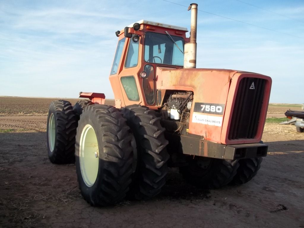

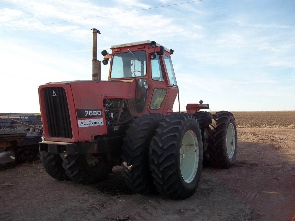

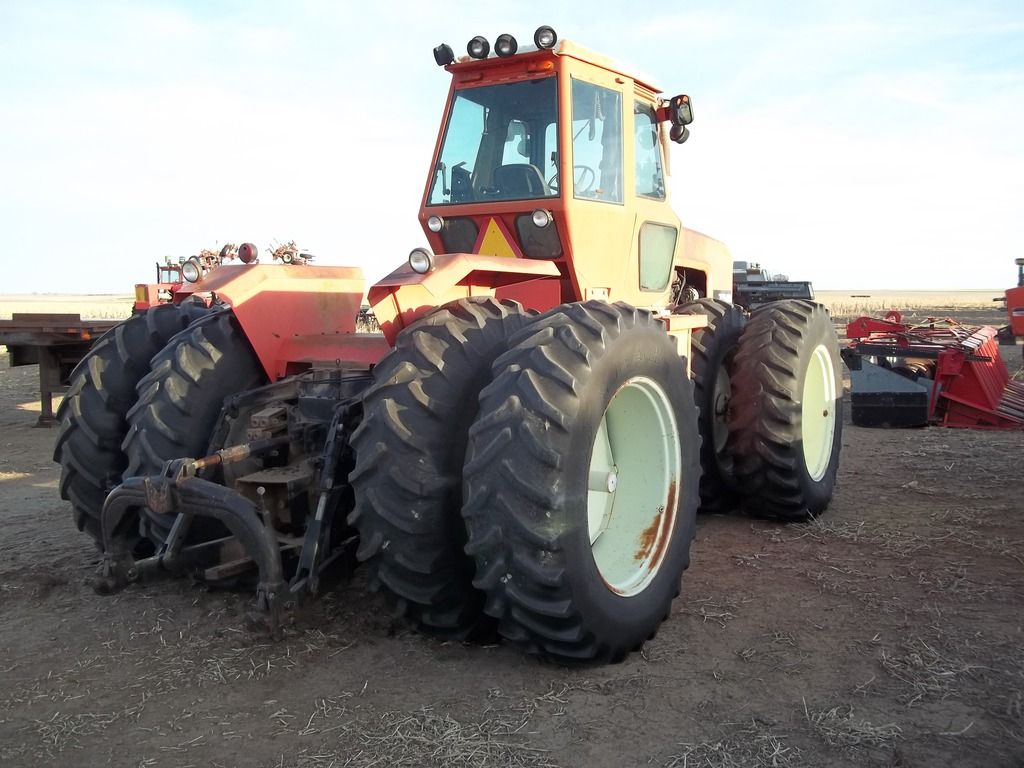

So, what does everyone think of the new purchase? :)
Cut the check today.
Out here it isnt unheard of, but long axles are none too common on a 7580 from what I have seen.
Unfortunately the QH and top link pictured dont go with the tractor, buddy is keeping them for his 7580.
Its definitely a fixer upper, but for under 4 grand, and it drove here 30 miles from the POs place.

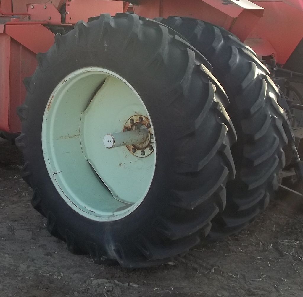

The last pic shows the best tires. luckily all 8 rims are perfect, dont see that often!
So, good decision or bad, its mine now. (kinda, need to get to work to pay off the loanshark, aka mom. :) )

As far as rolling stock, luckily its completely dry, and looks like its been that way since new, no residue anywhere. cant believe there isnt a single bend or cut in the rims, all 8 are perfect in every way.
It isn't overly heavy either, cast centers on double bevel rims inside, and 9 bolt pressed steel duals outer.
If we need to add weight, I plan on using a common method guys use on New Ag Talk, make up a weight bracket using front end weights so you can put it on the 3 point hitch for quick and easy ballasting for drawbar applications.
Mark has it right, you have to have it heavy on the front static ( I have heard as much as 65/35) and as it pulls it will weight transfer to the back to achieve 50/50 split under load.
