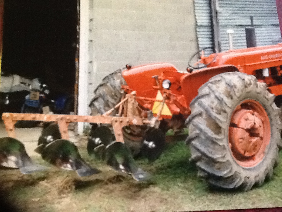

Hi everybody, need a hand putting a part to a plow. What one of these anchor brackets 328062,330096, or 320338 fits this plow. Can anyone help identify plow
Thanks

Looks like a 70 series plow, to me.  IIRR, 70's had the angled shanks, 80's had angled shanks and a shear bolt...Thumbs Up

CORRECTION : the 80 series were spring trip with angled shanks and and adjustable width frame. The 70 series were the same frame with shear bolt shanks.
Without a good look from the rear, it could also be a 60 series, as they had the angled shear bolt shanks with a fixed width frame.

According to my plow parts book, 328062 fits 60 series 2 or 3 bottom Plows 10" or 12" for B, CA, D, & WD series tractors.
33096 for the pull bar and beaming screw of 70 series 2 bottom plow 12" or 14" and 16" for B, CA, D & WD series tractors.
320338 fits 60 series according to my parts book, 2 & 3 bottom 10 to 16" spacing for B, CA, D, & WD tractors.
320338 also shows up on a single bottom 60  frame 14" and 16" bottoms for D-10 and D-12 tractors.
Over in the Knowledge Forum there is an entry titled Plows Parts 101 that includes a link to a downloadable plow frame parts book.

Yea I had read through that, just was asking to help clarify it. I went back through it. Looks like 60 series and the 320338 should be the part I want. Thanks guys
