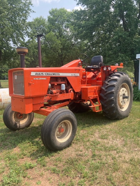

THAT IS a cool looking set up right there. What is your row spacing?
Wdtractorman View Drop Down
Joined: 24 Sep 2013
Location: Kentucky
Points: 975
Post Options Post Options   Thanks (0) Thanks(0)   Quote Wdtractorman Quote  Post ReplyReply Direct Link To This Post Posted: 31 Dec 2017 at 6:23pm
I think it on 36in rows, been using it to plant sweet corn and field corn for last few years.
