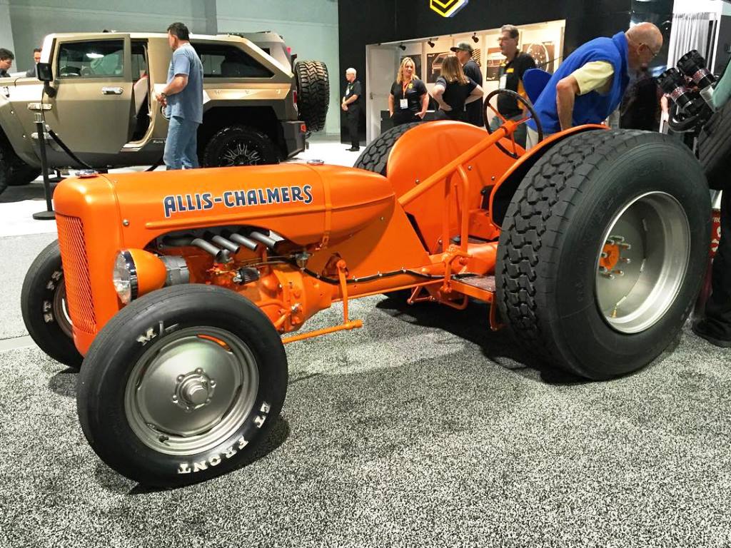

Looks really nice.   I do have a question about the steering geometry: it looks like the steering arms facing frontwards are narrower in front than at the pivots. Is this the case? Because I would think they would work better facing the back end. (The De Dion principle).
The idea is to have the inner wheel on a turn steer sharper than the outer one.
skeeters65 View Drop Down
Joined: 09 Jul 2015
Location: CT
Points: 371
Post Options Post Options   Thanks (0) Thanks(0)   Quote skeeters65 Quote  Post ReplyReply Direct Link To This Post Posted: 07 Apr 2016 at 8:33pm
Yes you are correct.
It steers fine this way. Tight turns are a bit difficult though. I may change it at some point but to get the tie rod under the tractor will be tough.

Maybe the steering arms could be cut off and angled outward? Maybe there isn't clearance.

could you possiby post a detailed picture of the wishbone mod,particularly the stabilizer rods front and rear mounting of ea thanks olddogtrac

Have a question with the final drives turned 180 how do you keep gears lubed. lots of work looks good. Randy

The pic under the heading,
"Front end before we pie cut it and re-welded it. 13.5* if I remember correct"
shows that there is a starter on it.
Edited by SteveC(NS) - 11 Sep 2017 at 7:06am
