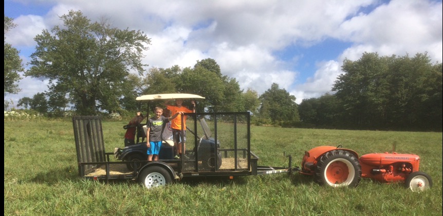

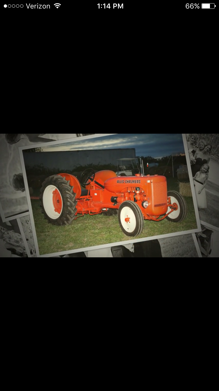

Hey guys I have been working on this B for a few months now. Thanks for answering all my questions. Your help has been greatly appreciated!!
I have been hesitant to post pics but some here have convinced me I should. Still got a long way to go but it's getting there.
I lowered the tractor by flipping the final drives and front end. Lowed the seat 2.5" and shortened the steering column 6.5", added WD fenders and brackets, painted the wheels and new rubber all around.
Lowered LED headlights
Front end before we pie cut it and re-welded it. 13.5* if I remember correct
Mocking up brake pedal angles
Filling brake lever holes in seat rails.
WD fender brackets cut and B drawbar pins welded on.
WD fender and brackets mounted to B final drives with draw bar pins as locators.
Seat rail mounting brackets welded on the final drive. (Welding cast is tough)

That is awesome! Show a photo of the front axle, I can not envision how you did that part!
Posted By: cpg
Date Posted: 08 Jan 2016 at 12:20pm
I have seen this done before and have always been curious; how did you add/check the fluid in the final drives?
Posted By: skeeters65
Date Posted: 08 Jan 2016 at 12:47pm
Photo of the front end added.
Guys I have hundreds of photos. If you want to see something just ask.
Cpg,
To check final drive fluid you need to pull the pan off the bottom (what is now the top) of the drive. You can add fluid the the drain plug or do it with the pan off.

Looks really nice.   I do have a question about the steering geometry: it looks like the steering arms facing frontwards are narrower in front than at the pivots. Is this the case? Because I would think they would work better facing the back end. (The De Dion principle).
The idea is to have the inner wheel on a turn steer sharper than the outer one.
Date Posted: 07 Apr 2016 at 8:33pm
Yes you are correct.
It steers fine this way. Tight turns are a bit difficult though. I may change it at some point but to get the tie rod under the tractor will be tough.

From my brothers wedding. This tractor ran around the farm for 2 days straight fetching people, beer and just cruising. Never a single issue and anyone and everyone was driving it. Can't say anything more.
Date Posted: 12 Sep 2017 at 8:09am
The boys were out beating on one of the golf carts at the wedding and broke it. The B had to go save the day!!
Date Posted: 12 Sep 2017 at 8:22am
Date Posted: 12 Sep 2017 at 8:23am
Last one from the wedding. My favorite. Me and my kids
