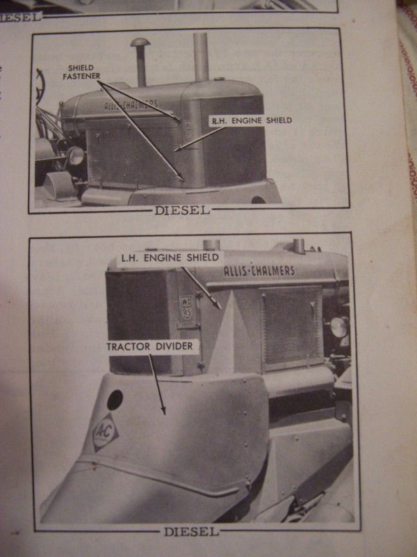

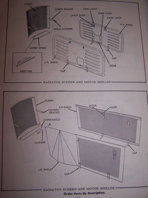

In thinking about my future 262-WD45 project, I was wondering if they ever made extended picker shields for the longer hood on the 45D? maybe first I should ask, was there a mounted picker that fit the 45D? I would like to have side shields for this project if I ever got around to it, maybe I'll have to make my own.

Yep. they did make the model 33 picker, adaptable to the WD45D.
Side shields were extended by a hole mesh screen on both sides.

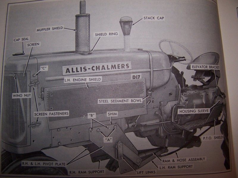

Did they make picker shields for the D17 diesel? If so, does anybody have any pics?

As promised, here ya go Bill and Bryan....
The WD45D, note the difference between the LH and RH side shields...
This is a comparison between the standard and the diesel (bottom shields) versions..
This is the D-17 version side shields for the 170 picker
