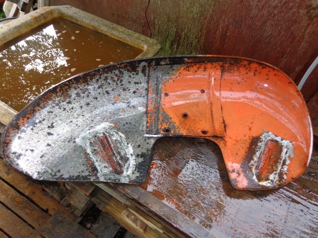

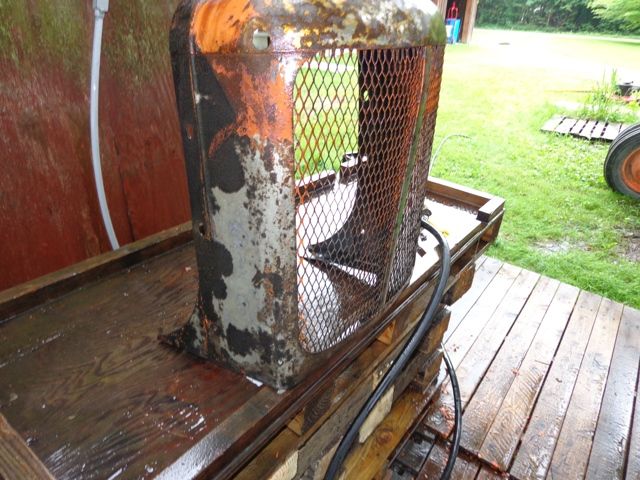

My Steps after electrolysis would be something like this.
-Removed from bath.
-Rinse with clean water.
-Wire brush the black soot off as you rinse.
-Blow dry with clean compressed air.
-Wire brush again after dry and blow off.
-Prime as soon as possible.
-Set aside or top coat as desired.
Even as slow as the process is I was still pressed to keep up with parts coming out of the E tank.
One of the WD grills
A WD fender
Edited by Sugarmaker - 10 Feb 2016 at 3:14pm
