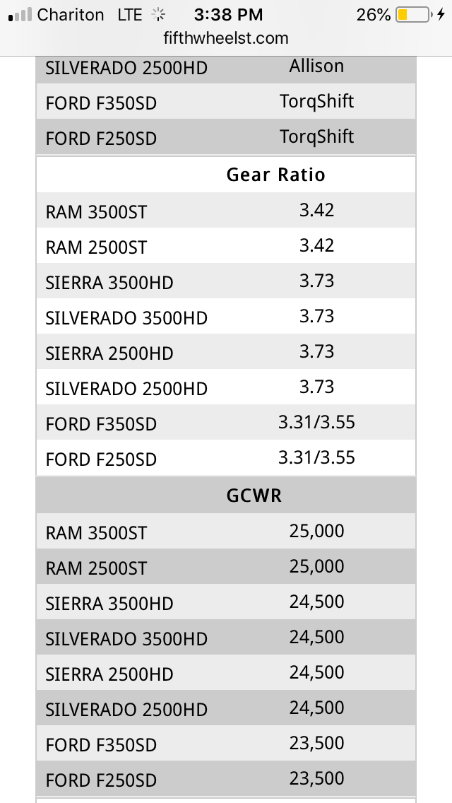

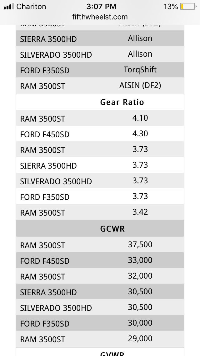

Post Options Post Options   Thanks (0) Thanks(0)   Quote 7060 Quote  Post ReplyReply Direct Link To This Post Posted: 24 Sep 2018 at 3:46pm
I found the combined weight rating or ”gvwr” on 2014 models. 24,500 for a single rear wheel and 30,500 for the dually. Which still isn’t cutting it for my truck I guess. I don’t want any questions so I guess I’ll stick with the semi. I was hoping to go this route instead of buying a step deck. Thanks for the information.
