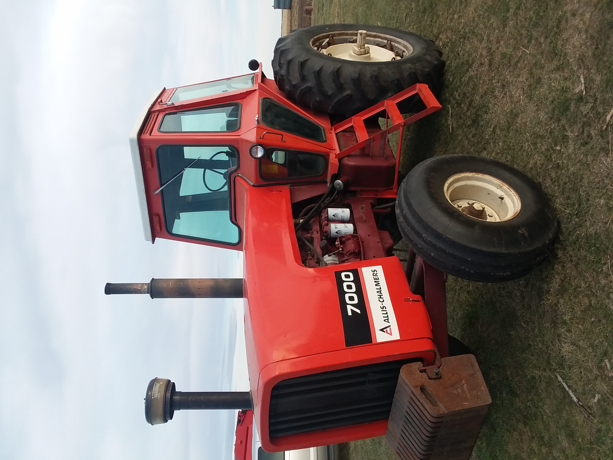

I'm looking at a maroon belly 7000 with 3000k original hours and it is clean, down to the original seat looking like new. The only problem is it has a rattle or growl in reverse. Worse case scenario what am I looking at for a repair bill, or should I just run from it. Thanks

looks to be in good shape, but with black chassis decals makes me think it's been repainted. At that point I begin to question the accuracy of any hour meter.
If it's in good shape, and priced right, hours aren't as big a deal as people make them out to be. Due to it's age, things will likely need attention regardless of said hours.

There were a few maroon belly 7000s made in early 78, Norm Swinfords book says 393,  I know of one maroon belly  from the factory with the large decals, i'm guessing its one of those. Being there were a few hundred of 7020s and 7045s built in late 77, that may explain the switch to the large decal before on the 7000 before the mechanical changes were ready for production on the black 7000 in 78.
injpumpEd View Drop Down
Location: Walnut IL
Points: 5096
Post Options Post Options   Thanks (0) Thanks(0)   Quote injpumpEd Quote  Post ReplyReply Direct Link To This Post Posted: 19 Apr 2020 at 11:16am
Interesting! I have never knowingly seen a mixed scheme tractor, but when I was a kid and they were new, it may not have payed attention, although I did notice a lot of details most overlooked lol! Someone could have just put different hood panels on too.

I see that 7000 has an 8 bolt front. I always thought they had 6 like my 190? Is it common to see a 7000 with the heavy front like that?

The heavy axle was an option.

Yes, the heavy front axle is known as a 7000 "special". That too I thought was a black chassis thing. This one is definitely interesting. we don't mean to pick it apart, but are simply questioning it's originality, or has someone pieced it together simply to sell. Know the serial?

Maroon tractors were also available with 8 bolt hubs, I have seen 3 of these.

It's a 78, yes heavy front end and definitely not repainted. I enjoy the discussion! Its absolutely a sweet heart and I'm not scared to invest some money into getting it fixed, I was just wondering how deep my pockets would have to be, lol

I still question it being a 1978 build. Maybe a mix or a replaced rear end. Allis was selling all its excess Accousta I cabs in the Fall of 1977. Dad bought a new one at a consignment auction that had 6 of them from Allis Chalmers and he mounted it on his 190XT that he also bought in 1977. Anyhow it happens that the cab Dad bought specifically says on the cab tag that it was built for the 7000 tractor and meets California roll over protection regs.

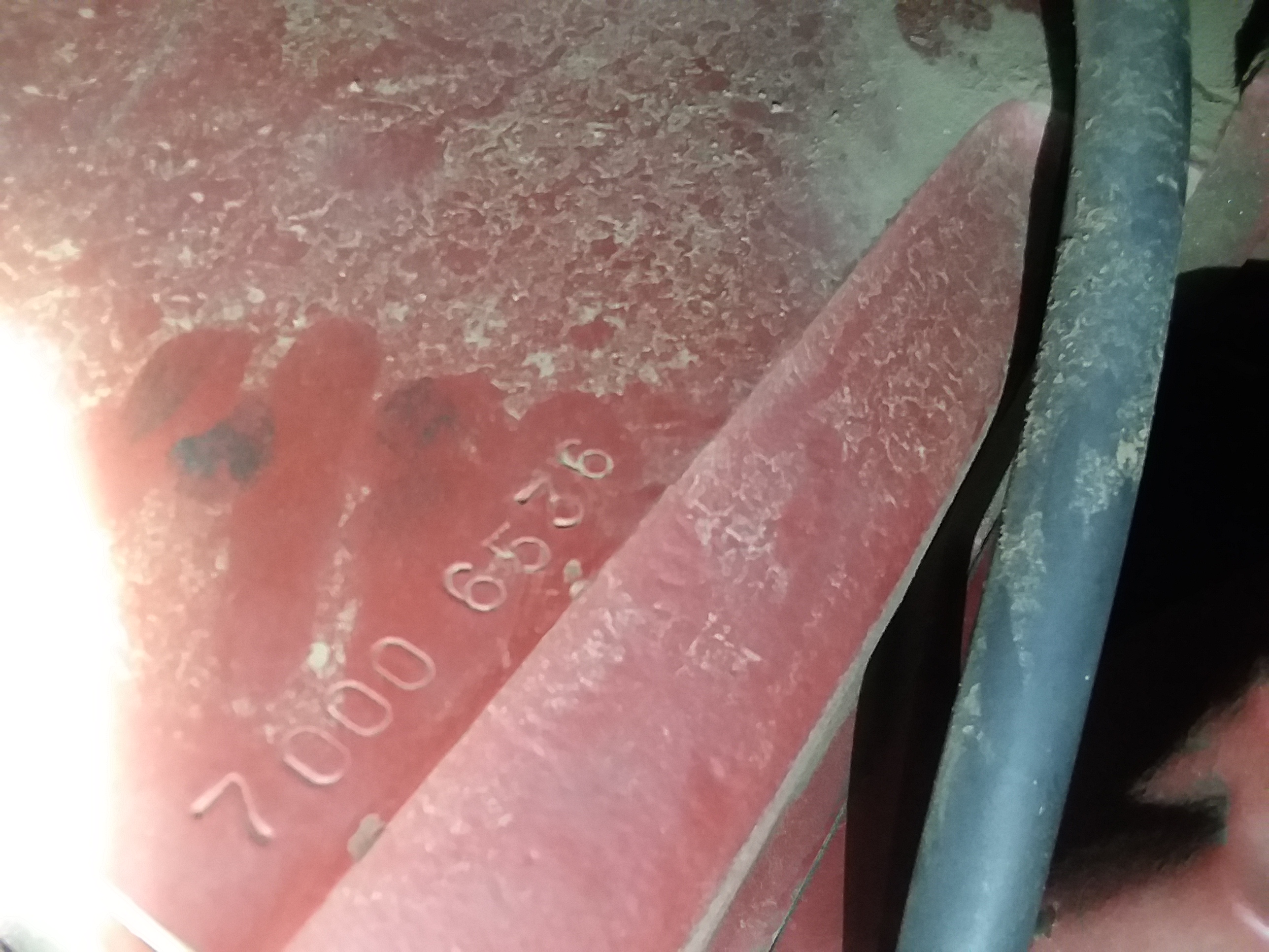

Here's the serial number, if I looked it up correctly it should be a 78

According to Tractor Data, model year 1978, started with serial number 6373, with the change over occurring at serial number 8000.

Unless Tractor Data is wrong, there you have it then. But Tractor Data has been wrong before. They used to claim the D17 was first built in 1958 at serial number 4300 and left out serial numbers 1001-4299. Not saying you are wrong, you're probably right, but because of Tractor Data Guide books back in the early 1990's, I had a hard time qualifying my D17 to pull in the local tractor pulls.

They didn't make the last maroon chassis s/n all the way to 7999 or 8000. They simply started the black chassis with the wet clutch at s/n 8001.
