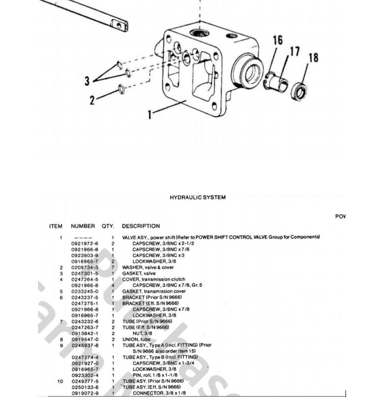

My power director valve on the One Ninety is leaking around the plunger.  I have a new seal to replace the old one but before I attempt to repair I would like to have the internal valve to tractor seals so that I can replace them.
The seals/orings/washers in question are #2 and #3 in the diagram.  The part numbers listed are #2 0209734-3 washer valve cover, and #3 0247301-5 Gasket valve.  I have searched using these numbers but cannot find a parts source.  Would anyone happen to know a universal part number or size?  Something that I can order from Mcmaster Carr or similar?

That parts number list is not corresponding with the picture. There's another list of numbers that aren't shown in the picture.

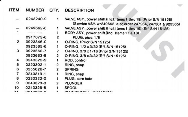

It uses a gasket and O rings. 70247301 gasket. 1 of #70923846, 1 of #70923565. 2 of#70923560, 2 of#70923663. The seal is #70243321. Some of the O rings go into grooves in the valve body and the others just slide over the exposed tubes.

Thanks for the parts numbers and for the clue that the page of numbers I had did not match the diagram.  It was the first page after the diagram and I assumed it was correct and the descriptions were close enough for the orings that I didn't think otherwise.  Next page in the book looks to have the correct parts with sizes.  It was right it front of me but didn't click! Thanks again for the help....
