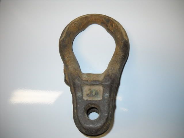

Go to ebay and type in (oliver clevis). The oliver clevis has been welded. It would probly be ok but I would skip it. The short clevis would be the John Deere clevis which is much like the allis clevis. for all I know the short clevises are the same for both John Deere and Allis Chalmers.
A good Oliver clevis usually goes between 20 and 30 bucks. I have not paid attention to what the short clevis goes for.

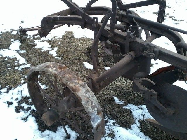

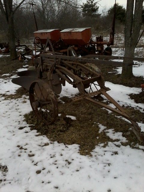

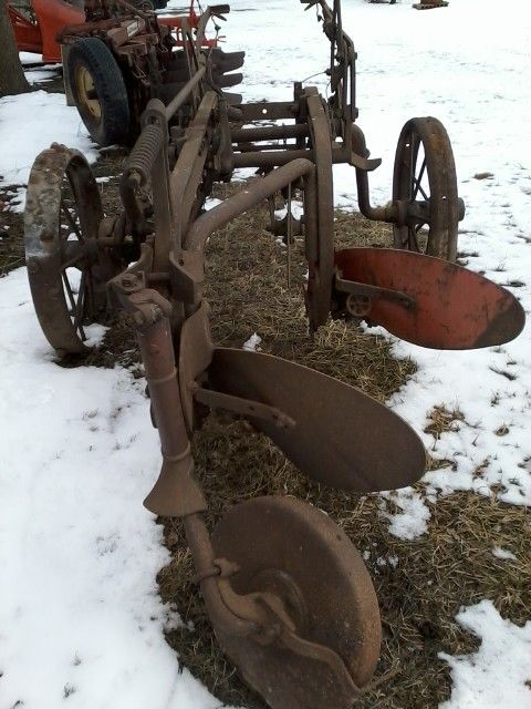

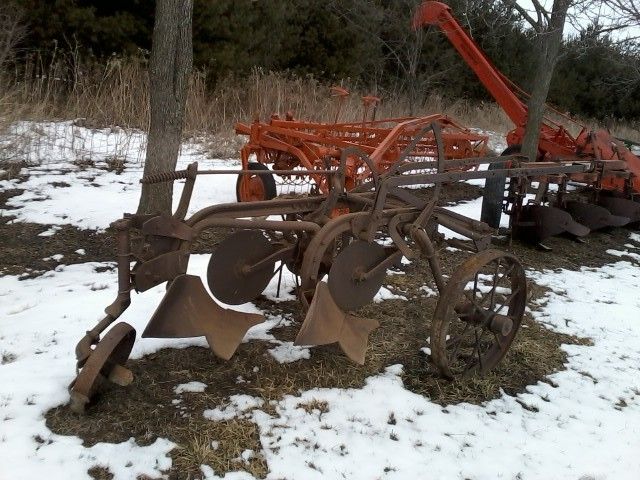

Here are some pics tonight..
Complete, has this wrench on the side next to the frame, hard to see in picture. I was told that was original to the plow??

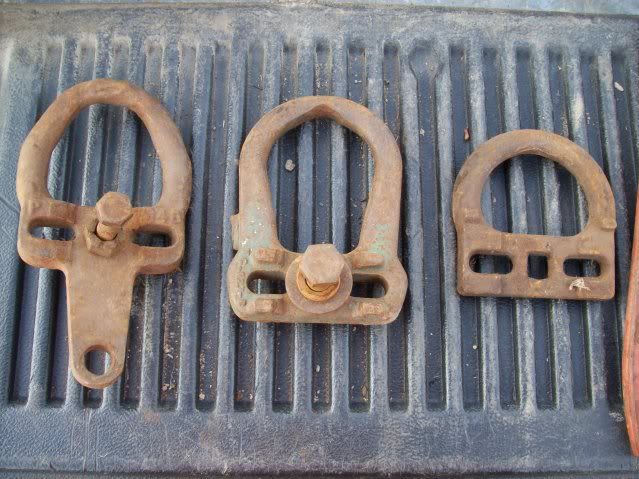

   Don, I can sell one of the two plow clevises on the left (right one not for sale) if they will work. $30 plus shipping.

Yes Don it is a #2.  They were the only ones that had tail wheels that carried the rear of the plow when out of the ground. They were also available with a long  rear landside and no wheel  or a rolling landside(most of the time improprerly called a tail wheel) Those types had an adjustable chain over pivot on the hitch to pick the rear of the plow completely off the ground when raised and all #1 and #4 plows were made this way. In case you need parts for the bottoms those are #24

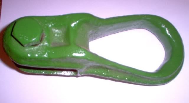

Randy, will have to think about it. Whats the green paint on the middle one? Oliver? Tell me it aint JD!!
Butch, thanks again. Think that wrench belongs to the plow? Its a double open ended wrench.
Also, I am missing 2 lugs on the drive wheel, if anyone has spares.

Shoot Don, I dont have any fancy fixens like prim and proper plow wrenches, LOL.
Can't say for sure about the wrench, one way to tell is every one of those I have ever been around that was prim and proper for the plow had openings that fit the nuts on the coulter bolts and the flat on the top of the shank. If more than two openings it should fit the nuts on the share draw bolt also.
Lugs are not an easy find, at least when I was wanting them. The head of the bolt wears down and then the lug can fall off the bolt and the bolt will rattle around until it will fall through the wheel.. If some are missng good chance the others are "there" too. Look closely at the lugs and you will see the parting line. I replace the bolts wth standard carrige bolts, 3/8" I think, been a while. They only look odd until you use the plow for half a day.

   Don, I don't think it is a John Deere clevis. These are Deere:

So I have a #1 then? or not? Mine has the fat axle hub so its a #2? I do know it has 2 steel wheels that I will not have to buy tires for! LOL

   Don, I agree with Butch yours is a #2.

Yes Don it is a #2. There are other ways to tell the differant series apart but they are harder to put in to type written words. Used to be easier,, until Randy screwed things up, LOL

I have one like the one on the right. It can be bought.
