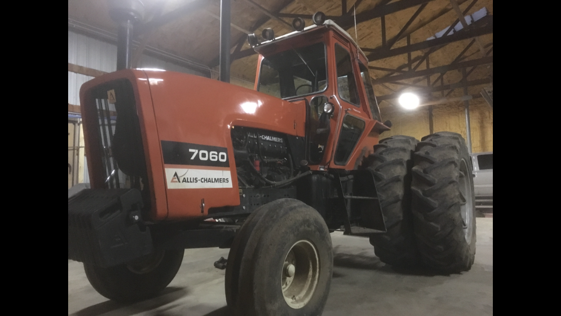

On another note, I’m ready to remove the injection pump this afternoon, and get it and probably the injectors cleaned and the pump rebuilt.
injpumpEd View Drop Down
Location: Walnut IL
Points: 5097
Post Options Post Options   Thanks (0) Thanks(0)   Quote injpumpEd Quote  Post ReplyReply Direct Link To This Post Posted: 14 Dec 2018 at 2:20pm
take the top cover off pump first to look inside and see how it looks. If clean, you can always try running a hose from a clean fuel can right to the inlet of the injection pump, center rear. If it's working right, it should suck fuel out and start squirting out the loosened lines in short time.
Just from looking in the timing plate, it was brown and gummy looking. I got the timing mark found, got the pump off and took everything into town for rebuild and cleaning, including all the lines except the large one from the tank, and also took the injectors in.
It really ought to run after this, as that had to be the problem. It should be all done by Wednesday.
While I have the alternator off, it’s going to another town to be checked out, and (hopefully not) rebuilt.
The next job to do on it is to get the manifold off, and replace it. While it’s that far apart, I’m thinking the turbo ought to get checked out, and it’ll probably need $500-600 of work.
I’m fairly confident that it will run well after all this, hopefully by next weekend.

Well, I have the pump and injectors back from rebuild, and $2,200 less in my pocket!!
They said everything was gummed up good, and the shut off cam and metering arm were broke off and laying in the pump. So, that left plenty of room for improvement, which means it has a good chance at running now!!
I’ll try and get it put together tomorrow, and maybe try to start it again.

They did have to replace the cam ring, and they had three pages of other stuff, coming to $1,200 parts, and around $900 labor.
I got the pump and lines mounted, now for the injectors, then I’m going to replace the fan, alternator, and A/C belts. As long as I don’t freeze into place, that is!!
Hopefully it runs good now, it better!!!

We got the injectors in, now all that’s left is getting the lines hooked up, putting the hand primer on, putting the alternator back on, then it should be ready to crank.
We usually don’t run the bio diesel, but I think it only has problems when it sits around. This tractor won’t sit around anymore now!! It pays to keep them moving.
Hopefully tomorrow it’ll be warmer, and we can start it then. We would have almost got it today, but it was cold at 20 degrees this morning, and by late afternoon the windchill was -5!

Today it runs!!! It took a few tries of getting the air bubbles worked out, then it started and ran smoothly!! It revs good, and purrs like a kitten.
I did replace the air filters, so that should be good.

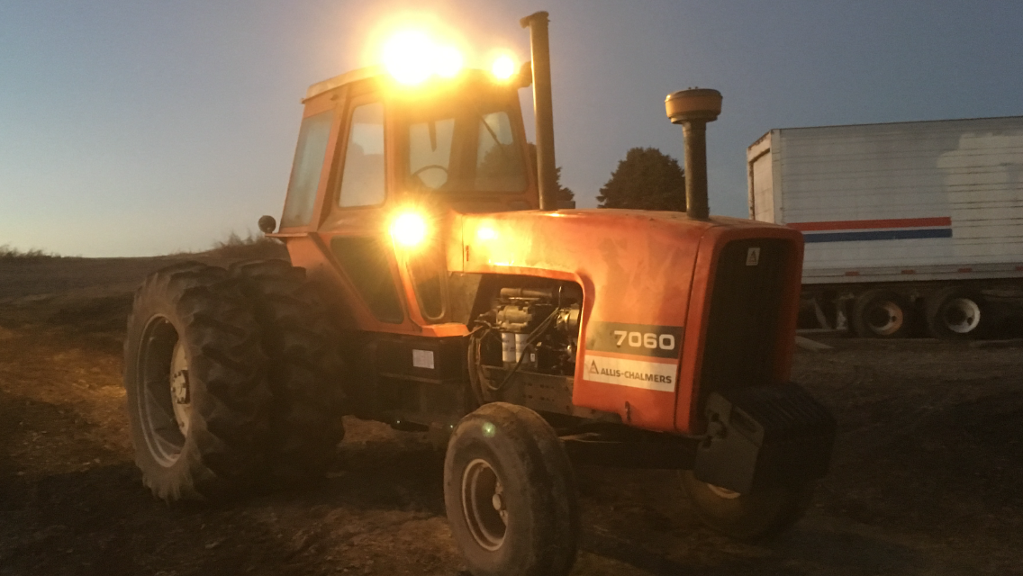

I got the new manifold on, and took it out for a ride!! It had much better power. That foam in the cab kit made a huge difference in noise, and now it feels like I’m driving it in 1978!!
