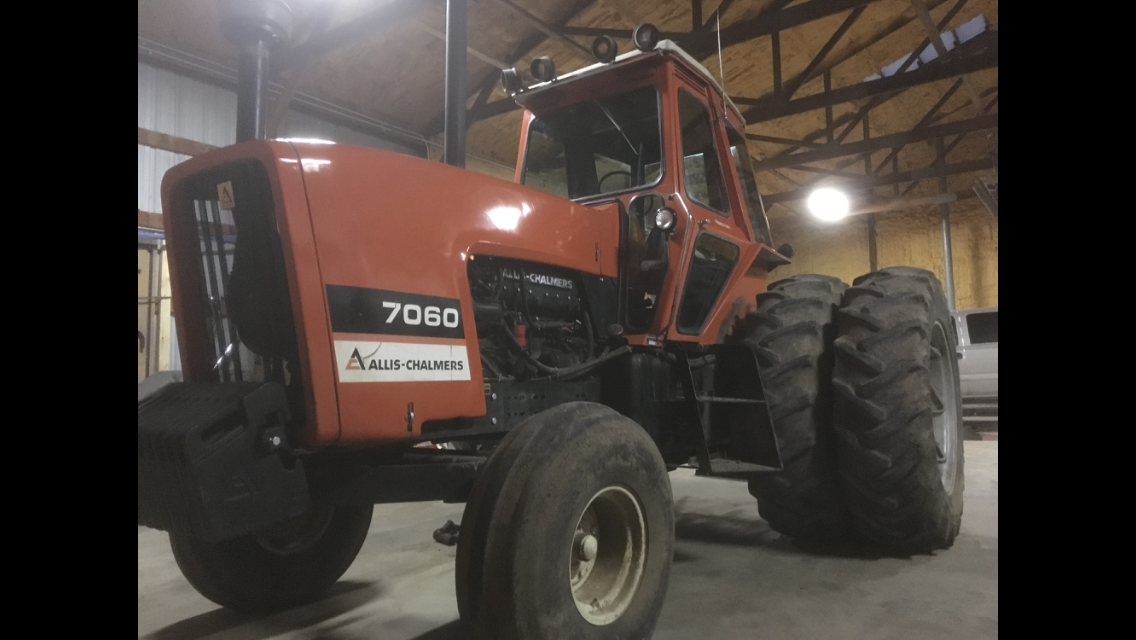

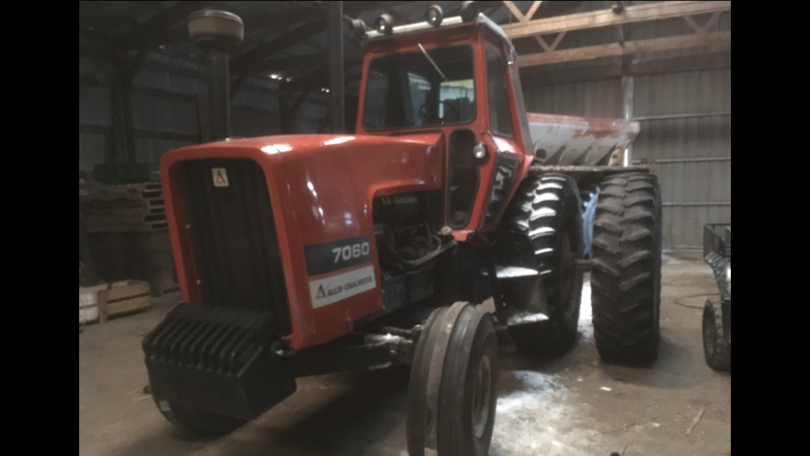

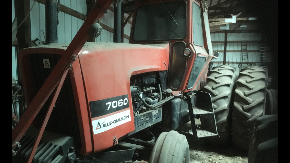

Although my list of projects to work on never actually gets smaller, I have started in on this one. It is a 1978 (black belly) 7060 powershift that has been sitting untouched in a shed for the past 10-15 years, with mice, and has somewhere in the 5000-6000 hour range. It is my cousin’s, and I’m planning on purchasing it to run on a 11 row soybean planter, alongside a few John Deere’s and my other Allis’s. Here is the list I have come across so far: New batteries Cab interior kit Fuel shut-off cable All fluids and filters Exhaust manifold Mirrors Fuel/water temp gauge Tires
I’m sure I’ll end up with more than that, but there’s a start. I hooked up a battery from my WD45, and all the lights still work, along with the dash lights, and even the radio. I did purchase two batteries yesterday for it, and I found out that if you put four batteries in, it would cost 10% of the entire tractor’s value!! It has probably 1/3 tank of fuel on the left tank, but I haven’t checked the right one. I’m planning on draining that into buckets and putting fresh in. I also purchased some Stanadyne additive to help get some lube ran through it. With the exhaust manifold, it is cracked. Is it a good idea to have it welded on, or just replace it?
Now for the tires! After a quick look around, it seems quite impossible to find a set of reasonably priced tires. The ones on it are likely the original duals, and probably the fronts also. The inside ones are better than the duals, but nothing impressive. I’m guessing I’ll need new front ones, but I’d like to find a set of good used Radials for the rears. Would 20.8R38’s go on in place of the original 18.4/38’s?
Does anyone here have any recommendations on what to do to this tractor after sitting for so long? Thanks in advance!!

That’s a good looking 7060. Glad your going to fix her up. With todays computerized and less reliable tractors, it makes more sense to me to put money in the older tractors. Neighbor had to have his green machine computer scanned because it wouldn’t start. Mechanic trip charge and a 10 minute diagnostic got him a bill for over $400. That didn’t include the repair. Any of the 3 sensors and a fuel pump could have been the issue. Turned out to be a $1,800 pump. Transmission also had to be tweaked by the laptop to correct a shifting issue, not sure how much that set him back. New tractors have nice features and are comfortable, but no way we can justify their price for our small farm. All AC to this day and plan to keep it that way until parts aren’t available. Look forward to seeing pictures when you get her cleaned And fixed up.

I would suggest removing your fuel pump and have Ed rebuild it. Sitting for that long has probably got things pretty gummed up. Does your cousin remember why he parked it? Drain and clean all fuel lines for sure.

It is entirely possible the pump is gummed, but if the fuel doesn't smell like latex house paint, install the batteries and crank it up. More than likely it is just fine. I would pre-oil it if you have that option, but as long as you don't rev it any after it starts for 30 seconds, it really isn't going to be that big of deal. If it has indeed been sitting for 15 years, that would likely take it back to when the fuel was good, and would last 25 years, not this current crap.

I've logged a few hours in 7060's. Still have the 2 Dad & I used to farm with. A red belly built in November of 1977 and a black belly built in 1981. Yes the engine can be turned over without opening the fuel shut off valve. I've accidentally done it. It's a manual shut off controlled by a pull out knob on the dash on the left side. I still enjoy driving these tractors. The 7000 series cab is actually a pretty good cab for the era. Not anywhere near as fancy as the new tractors and definitely without all the gadgets. And that's OK with me. The stadium lights were a great addition. Have you tried finding tires at a salvage yard?

I spent 20+ years owning a farm tire repair/ new tire business. If that were mine I would put a set of Firestone radials on the inside rims with new heavy duty radial tubes and mount the 2 best tires on the duals. Firestone has 2 different radial tires. I just checked with 2 of my old tire suppliers, if I still owned my tire shop, 18.4RX38 Firestone's should cost you around $1100.00 each put on the tractor+ the price of a new tube. Michlins are about $300.00 each higher. 18.4X38 firestone bias 10 ply were about $700.00 each + tube.

Unless them tires are just completely dry rotted or might pop any time,, I'd run em..there is no real bargains on tractor tires,,, ya jus hafta suck it up an get em...the 20.8's should be ok but do really need a wider rim..18.4's need 18 inch rim, 20.8's take a 18 inch I think...
2 batteries start my 7060 ok,, now really cold might need some help, but I don't use it in the winter..
I would do a complete new exhaust manifold..but I think ASAP has each section available...
A new cab interior will make it like a new one..if I ever get the cab top off mine again,, I will add dynomat, or similar for more noise control and insulation.. With the top off, clean the heat/AC cores,replace the heater hoses,make sure the heat valve works...I put a manual water cut off in one of the hoses on the engine..

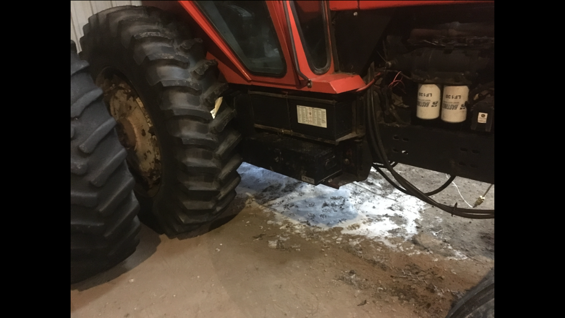

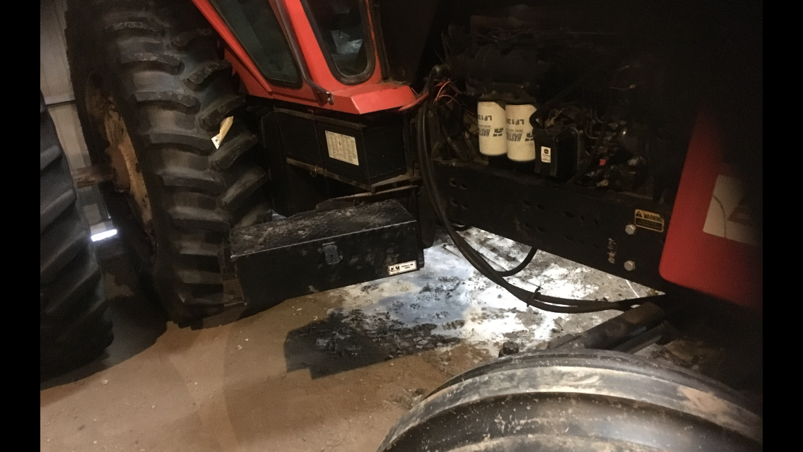

Well, even with a couple days of messing with it, it’s not running yet. I got the fuel drained and new put in, new fuel filter also. It did smoke while cranking towards the beginning, but it doesn’t really do much of that now, so I’m guessing it’s an air in the fuel problem. I pumped the primer good and many times, but it leaks fuel while pumping. Has anyone else had that be the problem, the primer letting air in through it? It would fire with ether, but not enough to run.

Yep, primer rubber parts go bad often, buy an entire primer kit from AGCO for less than $50.00, I think the last one I bought a couple years ago was in the 30s can't be sure, brain is old. Changing the primer takes like three minutes. Primer can let in a lot of air, but if you didn't push fuel through your filter, and let all the air out at the back of the pump before you fired it, you likely have a bunch of air in the pump. Only option now, is to fix the primer, and start from scratch.

Today I took the 7060 in to town to get it’s new tires on, and had a thrill ride. I was slowing down on a little (very icy!) hill, and as I idled down, it started to slide sideways. I hit the clutch (a mistake), which will also brake the wheels apparently. It slid sideways, headed for the pond on one side of the road, so I touched the left brake, and got it to the other ditch. Luckily, there was a driveway just ahead, and we could drive it back onto the road. If the duals weren’t on, it probably would have rolled over, and if it were on the other side, it would be upside down in a pond right now. I believe it’s going to come home on the highway, nice and slow, and not on the gravel road!!!
Besides that, I was looking for the jack bolts to remove the duals, and found a brand new hammerstrap at my cousin’s place!! You never know what treasures you’ll find over there!! I’ll get that top all cleaned up with an air compressor, and replace some hoses. The radio works good, and I think the speaker has a VW on it, and says it’s made in West Germany.

  Today I finished mounting a toolbox on it, on the bottom battery tray. It will swing out, and I think it should work good! I wanted it originally on the side of the frame, but the front tires wouldn’t clear it by much on the flat floor, let alone in a rough field. I also got the Precision Planting 20/20 monitor mounted, so it’s about ready to hook up to the planter.
Posted By: exSW
Date Posted: 13 Mar 2019 at 7:13pm
That tool box trick is cool. I may do that on my 7010. But it doesn't have a second tray.

Date Posted: 20 May 2019 at 10:04pm
 Well, here’s a picture of it in the field! It’s planted about 200 acres, and it’s been working pretty well. The first day was spent working out some minor bugs, but after that it’s done the job well. One thing was I had to have an Agco guy come out and shim the hydraulic deal to 2,800 psi instead of 2,400 to lift the planter (the planter wheels are turned out front instead of the rear, and when the planter’s loaded with 1,200 pounds of beans, 1,100 pounds of weights, plus the planters own weight, it’s a load for any hydraulics) Then the power shift cable came loose, and wouldn’t shift, but once we figured out what it was, it didn’t take long to fix. I got the air conditioner working, after having it evacuated, charged, found another hose that leaked, replaced that, and charged it again. Now it works great! It’s been tough with all this rain. It would just get dried out by an afternoon, and then it would run good until about midnight or 1:00, and start raining again. Only another 140 acres to go now, though!
Posted By: plummerscarin
Date Posted: 20 May 2019 at 10:21pm
Forgive my ignorance. Why are there weights on the planter hitch?
Posted By: Orange Glow
Date Posted: 20 May 2019 at 10:31pm
plummerscarin wrote:
Forgive my ignorance. Why are there weights on the planter hitch? | Oh, yeah, I forgot about those weights as well! I had only mentioned the suitcase ones on each row on the back.. Since the planter lift wheels are moved to the front (it was originally an 8 row 38” folding planter, now it’s a solid bar 11 row 19”) when it’s picked up, it’ll lift the hitch up. So even with those wheel weights on the tongue, it still takes weight off the tractor. And if you unhooked it while picked up, it would flip over backwards, even now.
