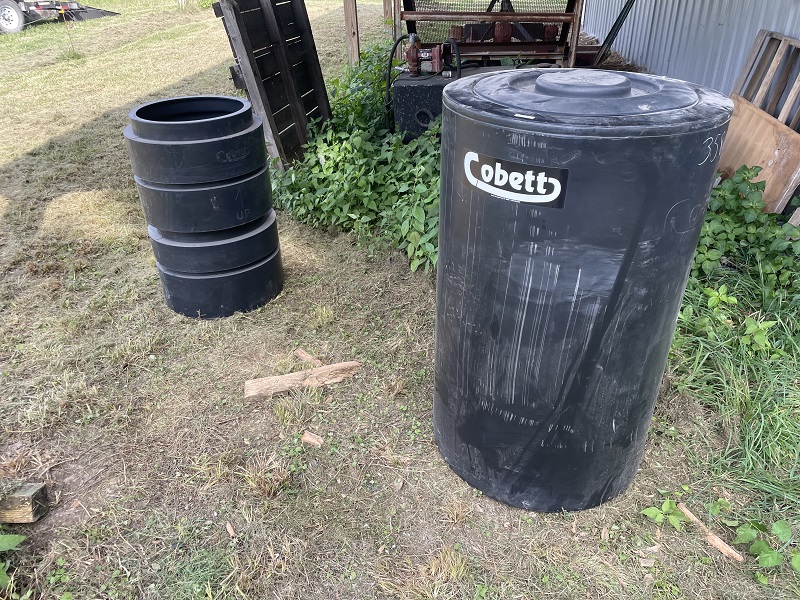

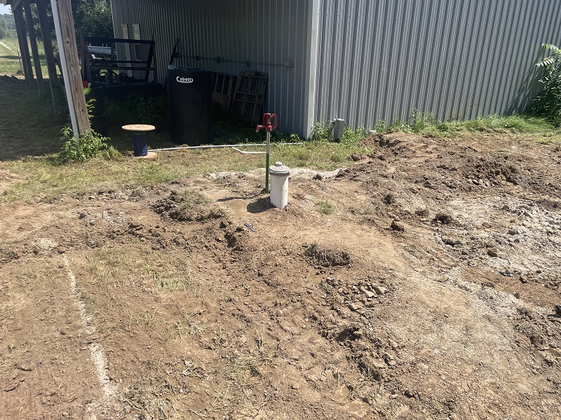

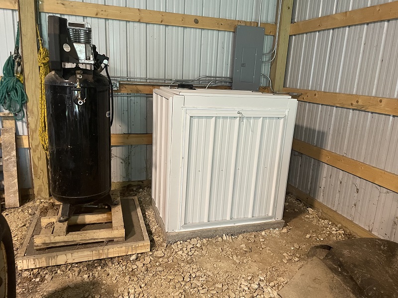

Decided was time to make certain we had plenty of water to supply renter's stock.  Have no ponds, the FSA wanted to situate one where was useless for a watering system where have two springs out of the creek bank but just a premonition needed to supplement.
300' deep well drilled, Mud Casing 9', hit the white sand at 120-130', and I stopped by to see progress, water was within 7' of casing top then.  Next day was running over, Artesion.
Will have to cut and paste to use link, YT not playing today.

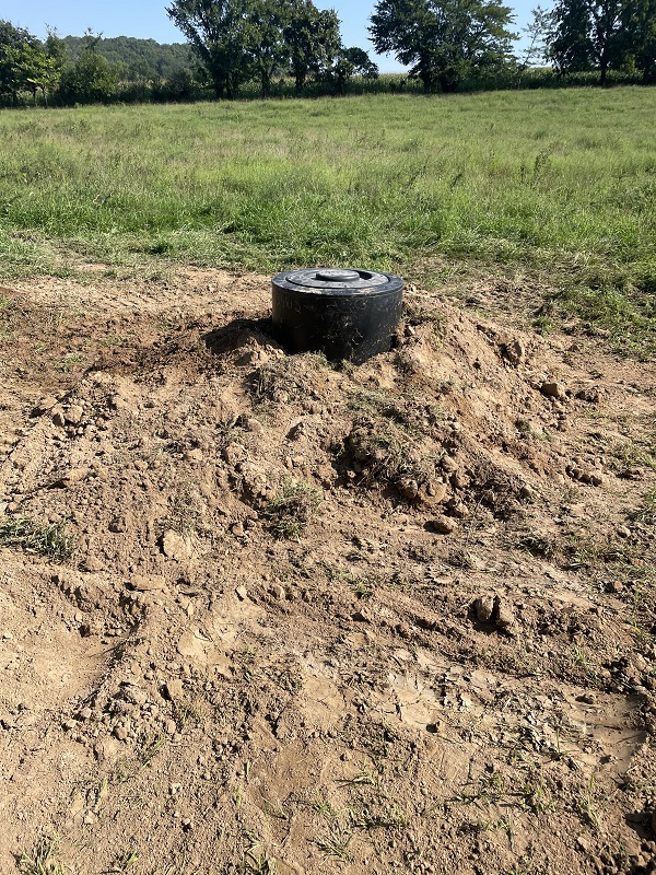

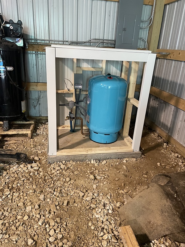

Gal from the company attached a drain so could finish up well set.  So I set a Concrete tank pad, and devised a structure Inside the barn that will house the Tank and Controls.
 The well company finished today.
COBETT Stock Waterer, Ground Source deicing system.
Nice set up with a Casing Drain to the creek behind barn so a Second pool of good Clean water for the stock there on opposite side of fence.
Day of drill completion
The last couple days
Still have to set Styrofoam insulation, tins on outer walls and assemble some form of door as well insulate but system is Live and water is SWEET!!!

Do Cobett waterers freeze in your country?   They are supposed not to....but ours freezes even in Kansas. I think they are very over rated.
Points: 35658
Post Options Post Options   Thanks (0) Thanks(0)   Quote DMiller Quote  Post ReplyReply Direct Link To This Post Posted: 25 Aug 2023 at 5:23pm
They can and do develop a Ice Line at top, some times close to 1/2" thick, the other waterers here do the same.  Just have to check and break the crust of a morning, by the time a herd drinks Ice is pretty well gone.

Have been some 14 artesian wells here in last couple years according to driller. Is a defined huge aquifer runs thru here, pretty shallow as to water depth. Several springs still run that have run for seemingly ever.   Spring houses were really prominent on the old farms but most have dried up. This one makes 4gpm best can figure 24/7.   Pump hanging at 120’, does not have to strain.

insulate that box and you can keep it from freezing with a small watt light bulb (not LED)
Points: 35658
Post Options Post Options   Thanks (0) Thanks(0)   Quote DMiller Quote  Post ReplyReply Direct Link To This Post Posted: 26 Aug 2023 at 4:43am
Have a good milkhouse heater not being used. Going to vet a Thermostatic Switch and set it up in the box during winter. Cannot get non LED bulbs to any value around here anymore.

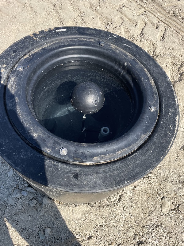

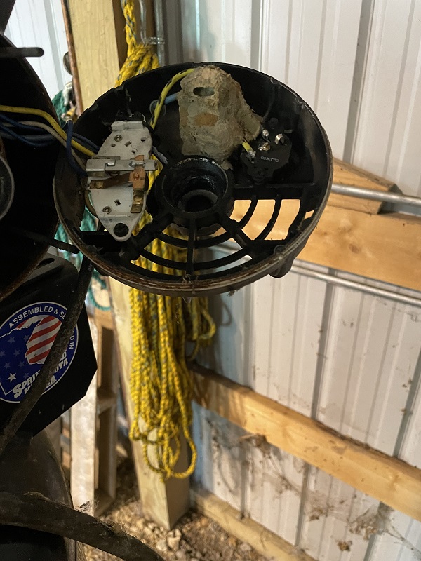

Post Options Post Options   Thanks (0) Thanks(0)   Quote DMiller Quote  Post ReplyReply Direct Link To This Post Posted: 24 Sep 2023 at 8:58am
Some end photos, and the Compressor got its Own slab poured where found it would not start just loudly hummed.  Danged Mud Dobbers!!  Placed a layer of 2" base stone around waterer, then added a cover layer of Screenings.  Tank house is insulated with 3/4" styrofoam based sheet stock between the 2x's and heater with a plug in thermostat set to 45 degrees is situated.  Did clean the motor starter contact points with a piece of notebook paper as were corrupted a little, next time will end up replacing that.  The COBETT float ball is six inches diameter for relative size.

The problem with brooder bulbs is they suck electric. We put a 25 watt bulb next to the pump and throw a piece of rolled rubber roofing over the whole thing. So simple it's stupid.

Points: 35658
Post Options Post Options   Thanks (0) Thanks(0)   Quote DMiller Quote  Post ReplyReply Direct Link To This Post Posted: 24 Sep 2023 at 11:43am
This sets inside our barn, cannot remember EVER having a partial barrel of water freeze inside the barn.  Still built the tank house to keep some varmints off this and perhaps the water in the tank will be insulated enough to keep from freezing.  Milkhouse heater set at 1300w setting, thermostat set for 45degrees so might not ever kick on, but is there for safe keeping.

Post Options Post Options   Thanks (0) Thanks(0)   Quote Dusty MI Quote  Post ReplyReply Direct Link To This Post Posted: 24 Sep 2023 at 8:32pm
Folding money, one dollar bill work ,well for cleaning electric contacts.
Points: 35658
Post Options Post Options   Thanks (0) Thanks(0)   Quote DMiller Quote  Post ReplyReply Direct Link To This Post Posted: 25 Sep 2023 at 4:34am
Did that years ago where a dollar bill may only be worth that use now.
