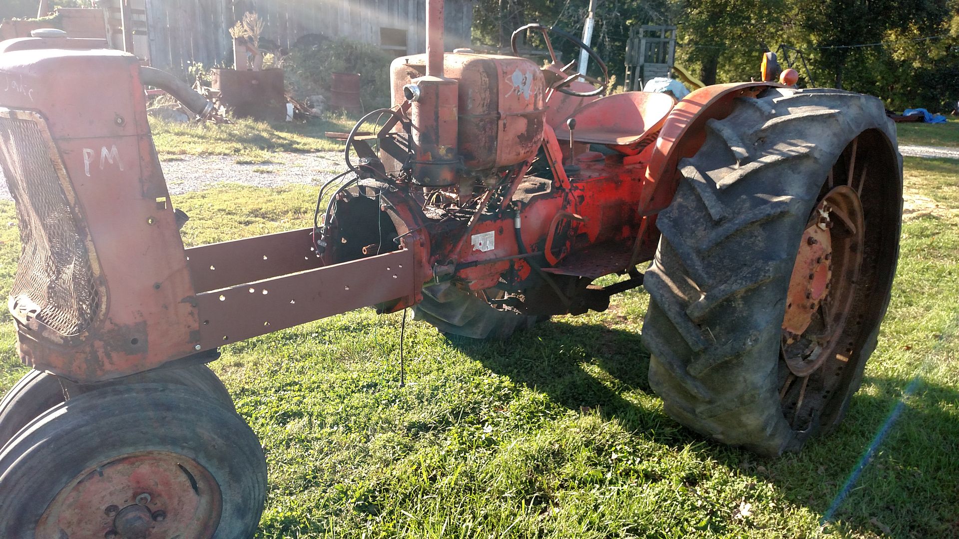

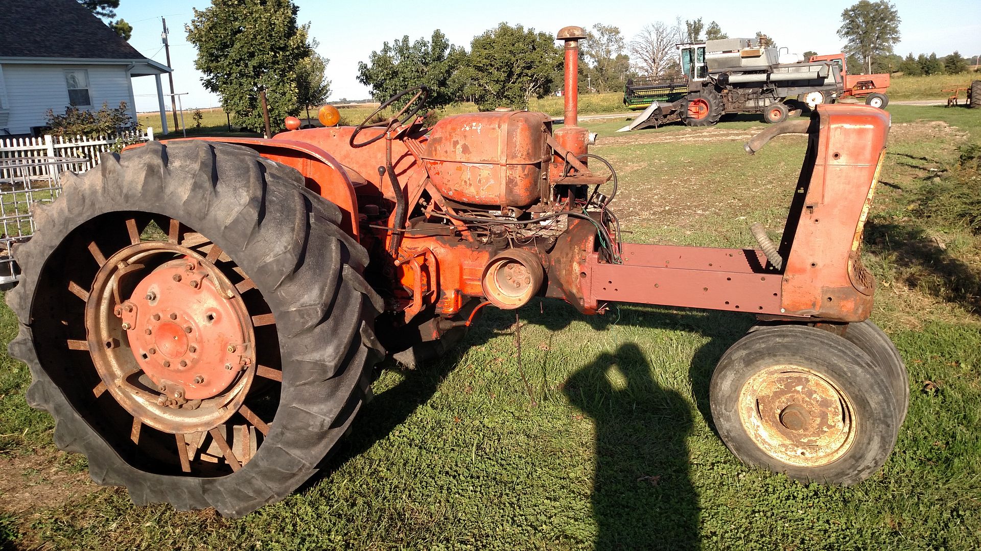

A buddy of mine and I made a road trip to Edwardsville IL last Sunday to pick up this old tractor. It turns out it is a 1958 Allis Chalmers D17 factory propane. It needs a few assorted parts (engine, flywheel, all the propane parts and little odds and ends). Has a neat set of steel wheels as well. I'll be removing them though.
Here are a few pics. It may be a little while before I get to this one, but I'll get it back together.

You will want to search ebay for the high octane engine kit if you want to build a 226 propane engine for that. It has the regulator gas tank as well so I am not sure what would have made it a factory propane looks like my serries 1 gas with the motor out right now. Honestly if it was mine I would look for a more modern diesel that would fit. I have looked into a few different diesel options. Or I would get a 226 gas and put it together as a gas those are great tractors with the gas motor. But I so wish I found a project one without a motor so I could build a fuel efficient diesel tractor out of it. That is my dream project I love my d17 just wish I had one that burned less money haying all summer. It is too bad that a 180 or 175 are not easy to find around here.

It has the matching propane side hood sheets. Someone at one time had converted it to gasoline. I actually forgot to mention that I bought it from dmpaul89. Thanks to him again and it was good talking with you.

I know you want to go back original so I'm not commenting about that, but I did notice what a fine set of fenders you have there, so I imagine the rest of what's left hasn't been abused.

I hope you were joking. Those fenders are shot. One is halfway usable, but the other is cracked all the way across.

I am wondering what type of steal wheels are hiding under the rubber. Could they be some thing that came out of a factory on an older tractor and where moved to the d17 or are they totally home made?   They look like a interesting puzzle to me.

Dan73, those rims the irons are welded to have had tires on them before... you can see where the tire irons bent the rim edges...

I looked closer at them tonight and they are two narrow rims put together and then had the spokes welded to the power adjust rims. Interesting way to do it.

The rear wheels means there is a good chance that Amish owned it at one time.
