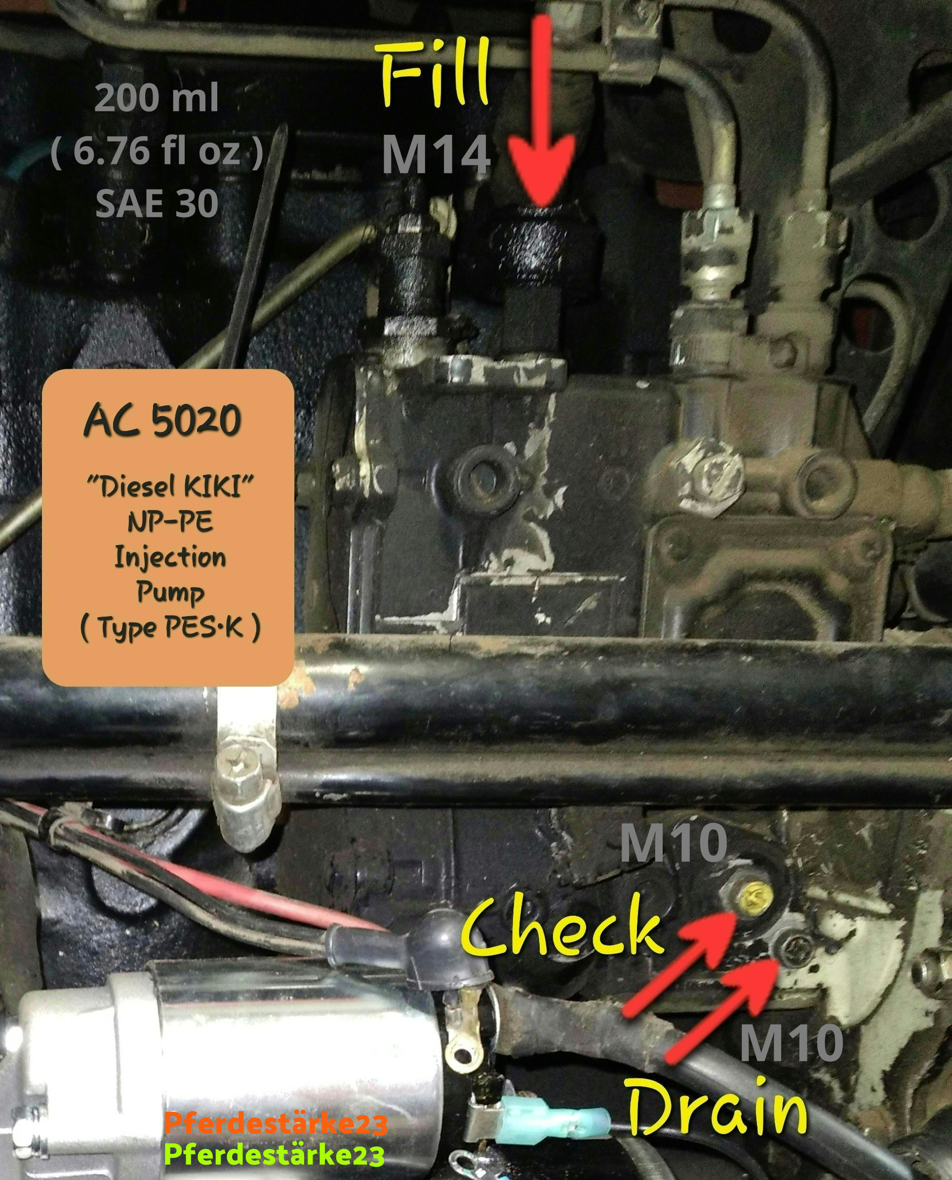

In regard to the
𝑨𝒍𝒍𝒊𝒔 𝑪𝒉𝒂𝒍𝒎𝒆𝒓𝒔 𝟓𝟎𝟐𝟎 . . .
Here, for your collection
of quick answers about
Jap engines . . .
Many don't realize
that the
TOYOSHA S126
has a separate
oil reservoir
for the
Injection Pump !
    ( Not a Patient's X-ray . . .  )
