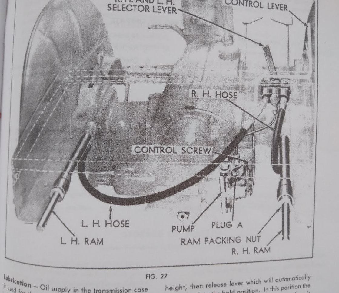

The diagram and my tractor do not match, so I am assuming there is a kit that can be added to match my tractor to the configuration from the manual. I have not found much in my search results to this point. Any tips on what to search for?

The diagram:

Looking at the pictures of the hydraulic pump it seems that the line for the oil flow to the hydraulic rams has been plugged.  It seems that unless you have an after market hydraulic pump attached - that I cannot see - you have no working hydraulics.
The first picture shows the proper hydraulic connection for a two way plow operation.
As stated above the hook up you presently have is an after market hitch.

Am I correct in my assumption that the two oval shaped openings in the back, under the ram mounts are where hoses are connected for oil flow to operate the hydraulic system on this tractor?
Based on the diagram picture I posted, that looks to be where hose connections belong.

I see what you mean by plugged. That looks easy enough to remedy. If I can find the parts. I'm wondering if I could manufacture something that might work, if I am unable to find the parts.

Am I correct in my assumption that the two oval shaped openings in the back, under the ram mounts are where hoses are connected for oil flow to operate the hydraulic system on this tractor?  No, those holes do nothing except possibly vent the brake housings...  hoses end at bottom of lift cyls, and start at hyd valve. plugged fiting on pump has a hard line that goes up to the hyd valve...Wink

I dug quite a bit more into the topic, and found some information about pump specs, which your post confirms. It's a high pressure low flow pump. The number I saw was 3200 psi. I also took a good hard look at the manual diagram again and some of it just clicked. I was staring right at it, and just missed it, i.e., the plugging terminology used by Bill, and then the hard line plumbed out of the pump.
That diagram is misleading (if one doesn't know what they're looking at), because it sure does look like those lines feed into the back part of that housing. But it makes sense now.

That ram selector lever, does it have a position where both rams are active?

john, i saw your post in the  WANT ADDS... Im not sure what you are trying to do. You might need to explain it to us, or do a little more thinking on what you want in the long term.. "MOST" of the B tractors have ONE cylinder and ONE hose that runs from the pump/ valve to the cylinder. They don not use the splitter valve mounted under the seat.
Here is a picture of a "standard" B setup with one cylinder and one hose from the pump. Then you have a LEVER under the seat to control the valve mounted on the pump.. This photo also has a ROCK SHAFT, which is the cross bar behind the seat that LIFTS you equipment when the cylinder pushes on the attached arm.. You might need that, depending on WHAT TYPE plow you plan to use..... you need to determine if you are going with a 3 point setup, a " beam under the tractor" type setup, or what ??  Your BLADE and DISC should use the same setup as you get for the PLOW, so plan ahead.

If yours has the selector valve, and second cyl pin, on the left, as is shown in your pictures, what you need is the double plow set up, shown in CTucker's picture.Wink

The radiator is still in the shop, so I decided to go ahead and pull the shifter plate and drain the transmission.
Next up, the hose. I think I'm going to go with the right side one plow setup for the time being.
Does the orientation of the ram matter? The manual looks like it feeds underneath, some of the pictures show it to the top.
