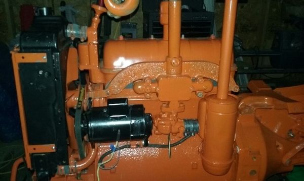

Just reviewed some of my pictures from the past and found one that shows the harness routed behind the air cleaner  and then over the top of generator bracket.  I am still unclear as to how they route the front light wires so they are out of the way.  I did post some pictures in my profile this morning, now I have to figure out how one views them.  also found it interesting reading the post from last night.  It was stated that the Model C never had a C decal on it.  Was glad to read that before I go and plaster decals all over.
Points: 12043
Post Options Post Options   Thanks (0) Thanks(0)   Quote Steve in NJ Quote  Post ReplyReply Direct Link To This Post Posted: 04 Dec 2016 at 7:36am
Ducking out from under the gas tank area the front the wiring harness ran behind the air cleaner, behind the Carburetor,  along side the block behind the Generator to the cutout relay. From there, the headlight circuit branched off from the cutout relay to the Headlight junction stud on the fan shroud. The Mag kill wire (if equipped) went around the front of the valve cover to the side of the Magneto where the "kill tab" is located. The headlight circuitry went over the top of the fan shroud to the right headlight, (sitting on the Tractor) and of coarse the left headlight got fed right off the junction. If you need some pics, I might have some that I took years ago of my B.  HTH

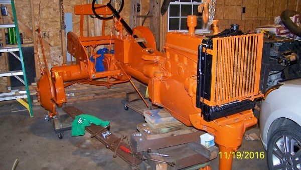

Looks GREAT!!!  NICE work so far.
NICE PICS!!  Just the right size too.

Thanks Ted, two years in the making so far and now winter is here so it slows me down, we are in the second day of a full snowstorm right now.

Not a C but I'm sure same as my B. U can c where it comes from behind the air cleaner. There is a wire that comes out of the harness that goes in front of the valve cover to the distributor/ or mag.    Hope this helps

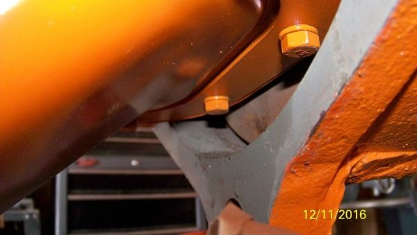

I need help again, There must be some kind of cover that goes over the flywheel on my C.  I have been asking around as to where I can find one and what it looks like and how it fastness on and haven't found the answer yet, I bet some of you guys know the answer.
Thanks
