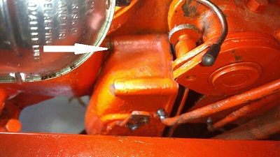

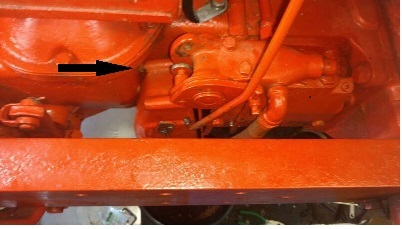

I have a steady drip from the part indicated by the arrow that I tried to fix today.
All of the bolts were loose so I tightened them and snapped one off in the process.  I can get it out but I cannot figure out how to get the valve (?) off.  It binds right where the bolt is and I cannot get it around the spring.
Do I need to take the entire pump off?  Are there any surprises I should be on the lookout for?  Besides gaskets, is there anything else I should do while is it is off?
Thanks in advance for your advice.

I should have been clearer.  The bolt near the arrow is fine I was just showing where I am getting hung up.  The broken one is on the bottom in front.  A little 1/4-20 POS that I cannot get to without removing the entire valve unit.
