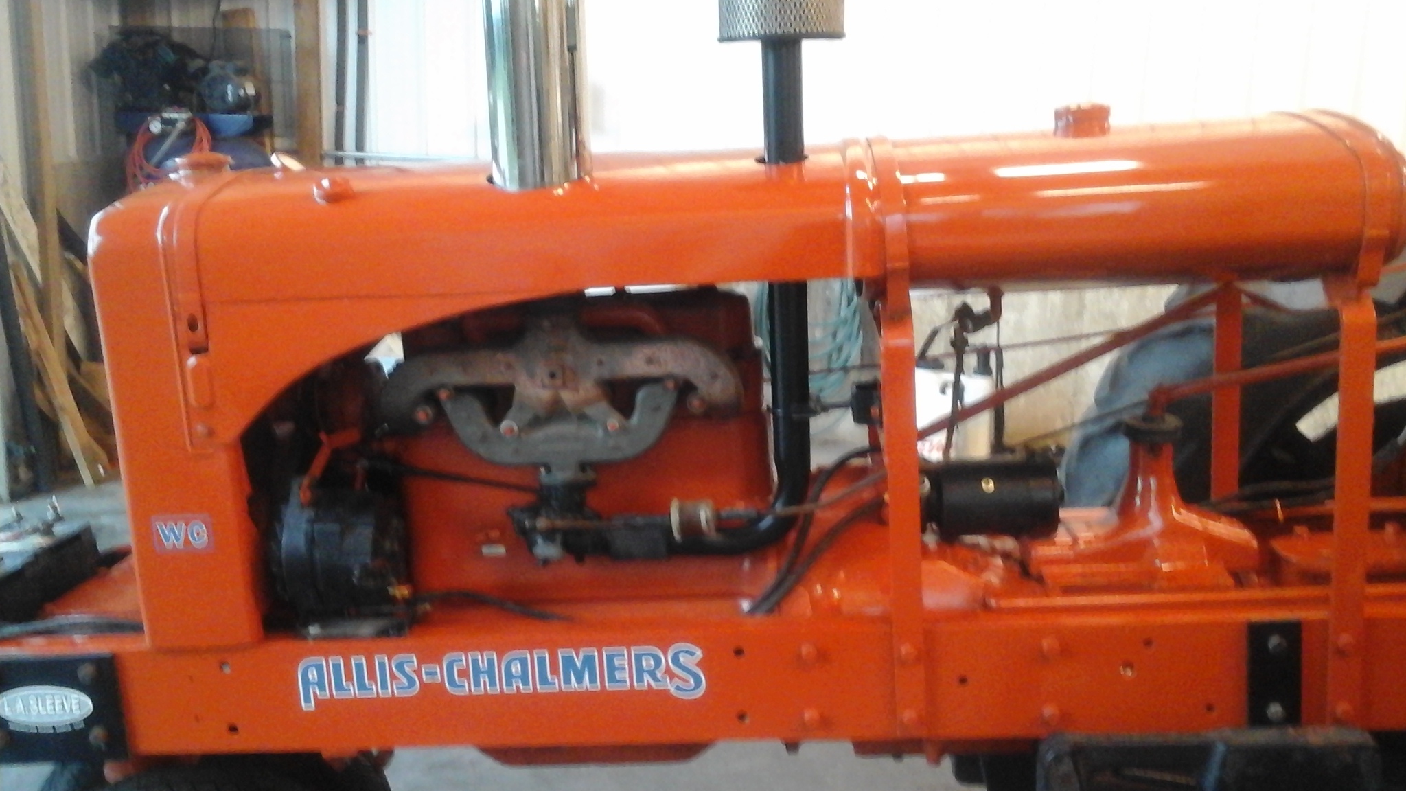

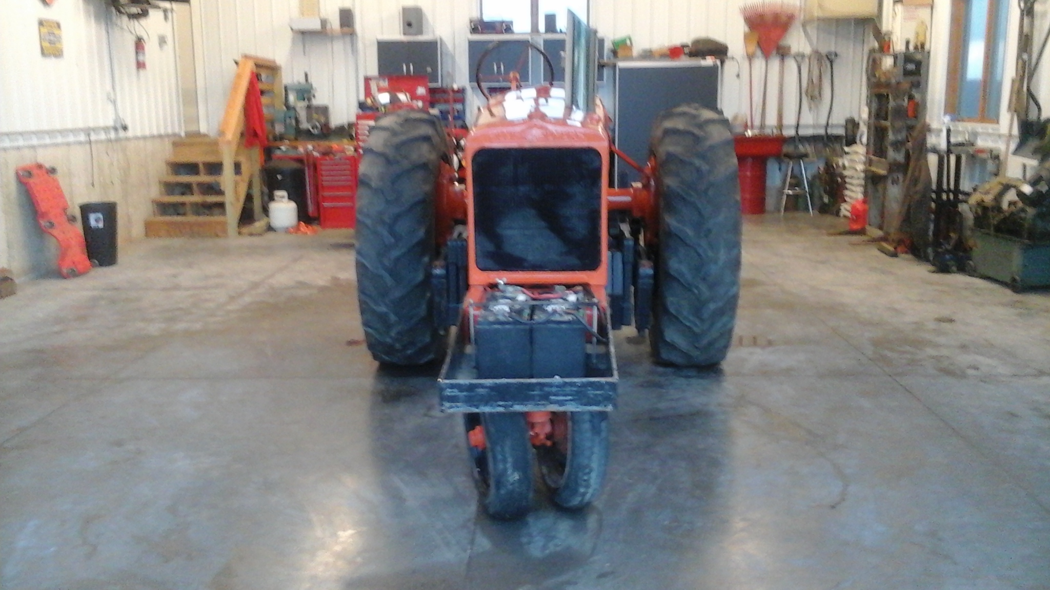

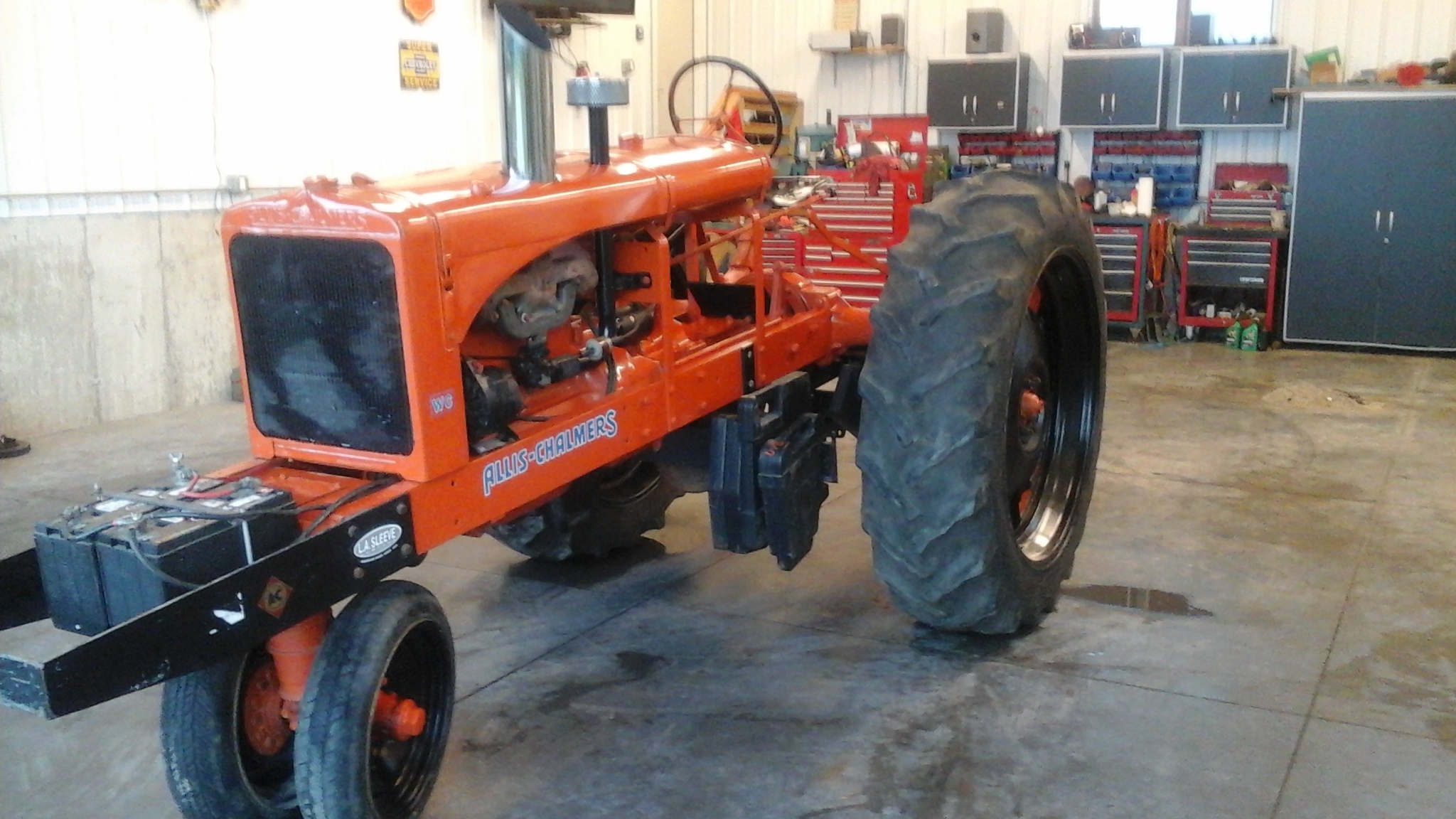

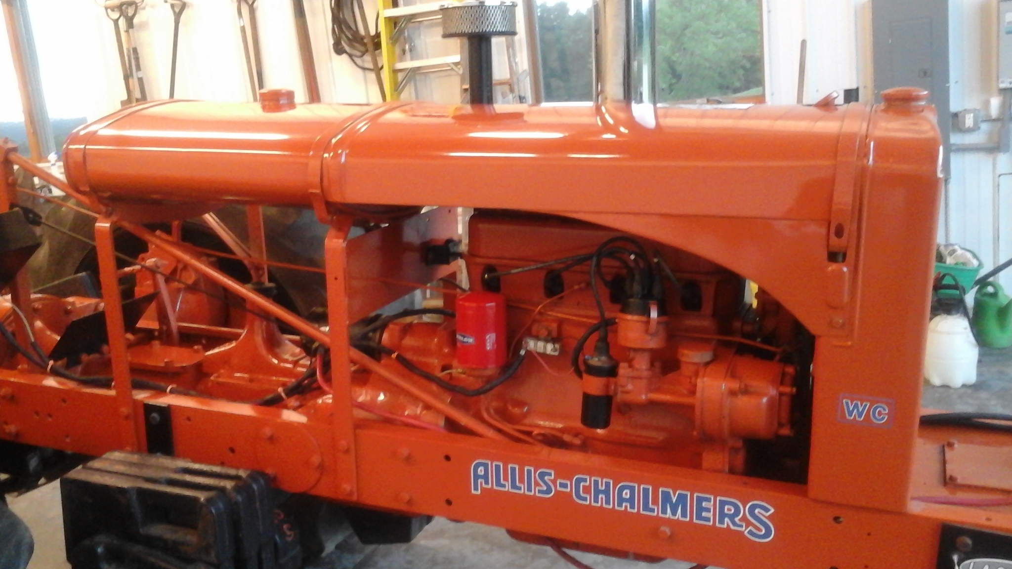

my 37 wc puller, 400 cube motor

What's done to arrive at 400 cubes?
Charlie
Robacpuller View Drop Down
Joined: 07 Apr 2016
Location: Wisconsin
Points: 248
Post Options Post Options   Thanks (0) Thanks(0)   Quote Robacpuller Quote  Post ReplyReply Direct Link To This Post Posted: 11 Jul 2016 at 8:10pm
I bored the block to 4.600 bore stroked the crank to 6 inches. Big block chev pistons, 8 inch 350 international rods. The head is stock wc but a lot of porting and polishing. Big block chev valves 192 intakes 160 exhaust. Intake is ported and polished to Mach head. The carb is from a D17, but I opened it up real big I made a new ventury 1.480. I run 20% over rpms. Cam is ground. I pulled on Sunday in 6000 lb. Class and I ran out of power, it was an 8 mph class Iran 5 mph, a lot of the tractors were 100 hp more than me. I got 8th out of 16.Not bad for a 110 hp wc. A lot of old timers gave me the thumbs up. I recorded it so if I get it figured out I will have it on this site. I did all the work myself, my friend bored the block. The crank is a Merfeld crank. I didn't have grind much off the block to get clerance using the 350 rods. It is D17 block and crank. I would like to start building these motors for people it was fun doing.
