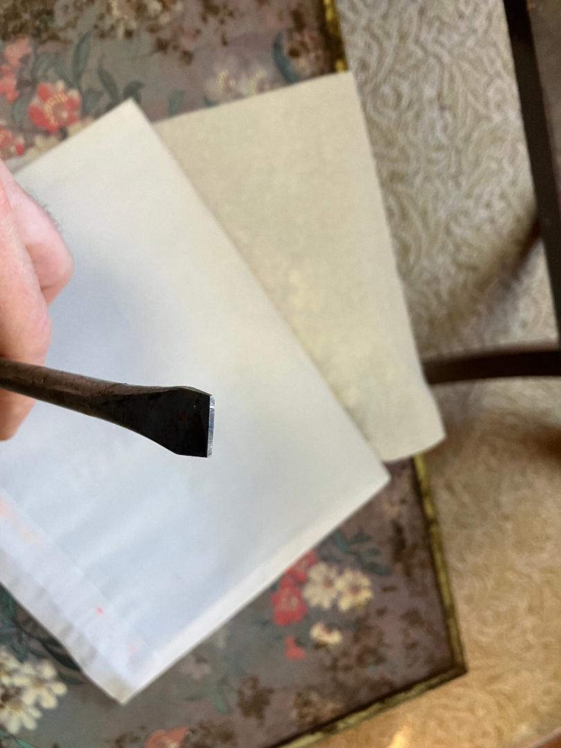

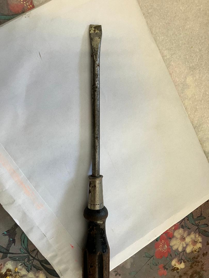

I was wondering, is there a special tool that takes out a needle see on a Maverl carburetor? It looks like it may be a big white screwdriver would work, but having trouble trying to find one. Any ideas? Thanks.

Use a sickle section or a harden piece of metal that will fit the slot.                      MACK

Facing this trouble years ago I found an old screwdriver and ground it to fit. Works darn good.

Mike has a good idea. To remove stubborn seats for the needle valve, I use a GM brake spoon for adjusting brakes. Fits in the slot nice n' snug, and if you need a little extra torque on the real stubborn seats, I put my small adjustable wrench on the blade and get a little more leverage. Make sure you have the body of the Carb firmly anchored in the vise. Don't ask me how I know that.......
If you have to tackle getting the nozzle out, (which can be a real bear sometimes) I took a large screwdriver, test fit the blade in the jet slot on a spare nozzle, then I ground the sides of the blade down till it fit nicely into the cavity without hitting the threads, and crank the nozzles out ever so slow.  A screwdriver with a square shank is a plus just in case ya gotta' git' that small adjustable back out again to crank a stubborn nozzle out. The only time I have an issue trying to get a nozzle out is if somebody already been there and totally screwed up the jet slot. Now you have a REAL problem goin' on....!

Someone makes a screwdriver for this. I have one, will have to look and see if a name is on it.
