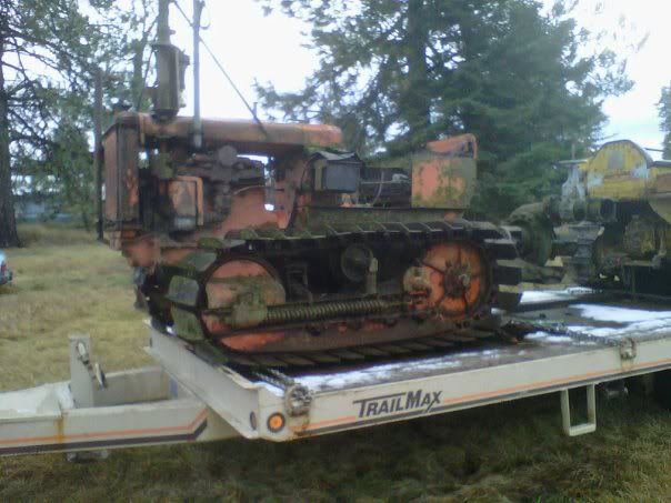

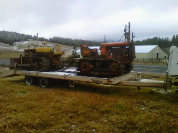

Here are a couple of quick cell phone pictures I took,glad I got it.

Post Options Post Options   Thanks (0) Thanks(0)   Quote steve aust Quote  Post ReplyReply Direct Link To This Post Posted: 19 Nov 2010 at 9:54pm
That looks like a nice little crawler, well done
