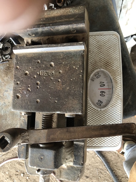

ย  Hey Dave Kamp, many Thanks for ID'ing this brute for us,,,,I felt it was a quality piece as it is well built and has lasted an awful long time and has had very little use. I did not show very good pics as both jaws are almost cherry (whoops, can we say that here?) The only'ist thing I can throw sticks at is the operator must of been far sighted as they did drill thru the work a few times and into the btm of frame but not near enough to affect it's effectiveness or longivity,, If I can bail out of bed this pm I;m go to post office and see bout a flat rate box for this brute,,,,,

joe ... since the holes are a VISUAL problem and not a STRENGTH problem, you can clean out the holes with a burr and fill them with JB weld and sand smooth.. I have done that and it helps the LOOKS 100%... and the JB is about the same color as sandblasted steel.
I've done that... and I've had machines with holes drilled elsewhere that I didn't want, and I fixed 'em in other ways... like... find an appropriate sized tap, tap it for threads, red-loctite thread in a screw, saw it off 1/8" proud, then give it a quick 'kiss' with 4" grinder and flapdisk... then paint! ;-)

most of your "HOLES" see to be on the top of the movable jaw  !!  You can fill them, then PAINT and no one will know... Normally the holes are between the jaws in the frame rails... that area is not painted, but the JB fills in well.

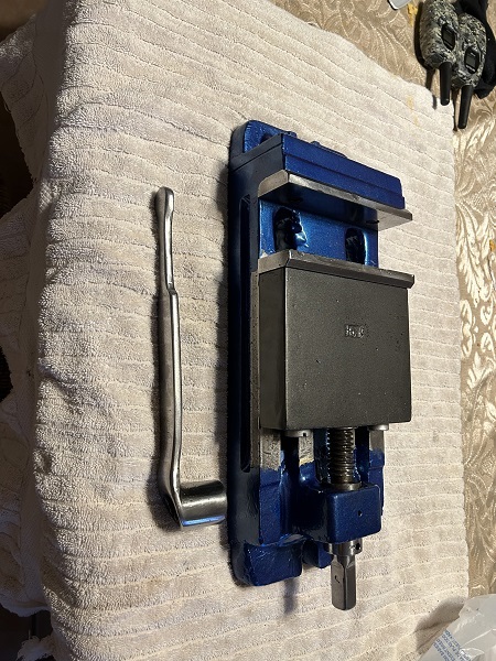

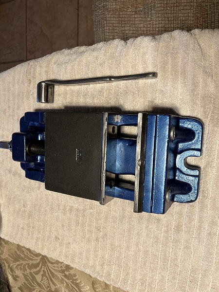

  Well,, you guys take a gander at this tool and tell me if ole Thad might like it now,,,,,? Just goes to say,,,a little amount of elbow grease will do wonders with good quality tools that have suffered some abuse,,,,.
 That JB Weld will work wonders and will also hide a multitude of sin.,,,,WinkWink
 Only'isr thing is now to figure how to get this heavy sob into Thad's hands,,,,just weighs 53 pounds,,!! Don't believe I'm gonna send USPS,,,,LOL

Appears an old Milton

WOW......... thats PURDY !!  Clap

Wow that looks too good to use.
Purdy.

 Well, I Thank yee, Guys,,,!! That JB Weld is super great stuff ain't it?,,Clap Don't have an idee how old this tool  is but the ways are perfect  and just as tight as a youn,,,,er,,,never mind!!Wink  You can spin the jaw handle with one finger just as slick as,,,,well,,there I go again,,,,LOL It does have a tiny lube hole for the jaw screw and wonder if there was ever a oil chingas there? I may try to machine a press fit plastic plug or maybe brass to keep trash out of that spot,,,?
 The weight of this thing is really impressing me cause you DO NOT want to have to move this behemoth more than once a year,,, 56 Lbs of heavy iron!! Now,, getting it to ole Thad is next challenge,,,,,Clap

Nice cleanup, Joe!
In a typical shop, a guy would put a drop or two of way oil (like Vactra) in that lube point, and a little on it's ways and leadscrew... mebbie every time or two that they oiled any nearby machine's manual lube points.  They'd also put a little on any nearby chucks and tooling... then move on to the next work bay.  One of my (now long passed) buddies started at IH as the 'oil cart' guy- he pulled a wagon with a barrel and hand pump, refilling oil cans and topping the Bijur automatics' reservoirs... once a day, from one end of the wing, to the other, and back.  Guys on the line would stop the machine between parts just long enough for him to get in there...
