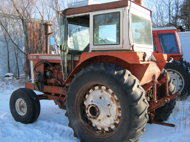

These are the kind of dual hubs Mack is talking about.
We never had a problem with them coming loose though, I am sure others did.  This was our heavy tillage tractor for years, and it always had the dual on.
Still in use:
