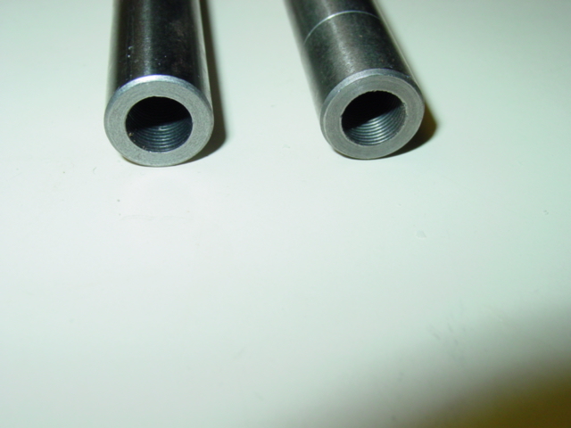

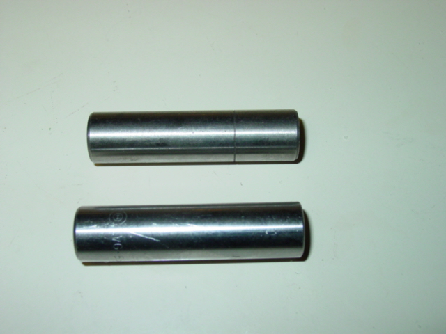

I would never try to reuse valve guides. They are cheap and easy to replace. The new ones. The ones you would take out would have a head on top and the new ones do not. Some have a scribe line for the depth. The guides that don't you just measure. I ground a block for the height. I ground a punch pin with a pilot to go inside that was slightly smaller on the outside than the guide. I mostly used a press to remove and replace the guides. I have also used the punch and a hammer.

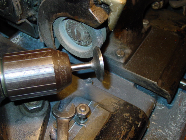

Lapping is a final step in sealing up the valve to seat. Lapping until you have groove is short term at best. I was taught to spark the new valve faces in the 1950's and would still if I was doing them now.
Sparking a new valve is only seeing a spark as it rotates slightly against the wheel.

Valve guilds can make or break a long term valve job. Intake clearance, generally runs .001 - .002 and exhaust clearance .002 - .003.
To much intake clearance leads to pulling oil into the combustion chamber. If you see build up on the under side of the valve, the guild has way to much clearance.
To much exhaust clearance will contaminate the oil, caused by exhaust gases getting into the crankcase.
Bronze valve guilds are preferable, if you can get them. They last longer and will stick less.
Good guilds means that the equipment doing the grinding, both the value and seat, needs to be accurate. With only .001 - .002 clearance, to work with the valve run out shouldn't exceed .001 or, the valve will hit the seat, off center.. Thoughs of you that have value grinding machines, need to check the run out, with a new valve, in place. Check it with 7/16, 3/8 and 11/32 valve stems, to be sure the chuck isn't warn over any part of that range.
For valve seat grinders (or cutters), the guild for the stone and the stone arbor needs to be in good shape. If the guild isn't in the center of the of the valve guild and well seated, the seat will off center of the valve.
When you lap, use Dykem or a wide felt tip pen, to mark the valve seat, lap until you get a pattern .045 - .060 on the intake and .060 - .085 on the exhaust. Then, came back with a 15 deg stone for 30 deg seat or a 30 deg stone for 45 deg seats and grind to your lapped pattern. You should also touch up the the inside of the seat, with a 45 or 60 deg stone or cutter. I like using cutters for this, stones like to grab and chatter, as well as break.
One other thing, if you have a value grinder, break the back edge of the value seat, at 15 deg less, it will increase flow. You can reduce it to the valve contact area or so. Do this when you first grind the valve or to new valves. It also helps with lapping.
