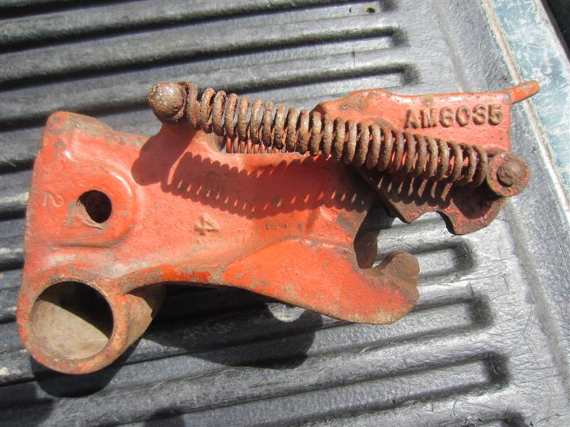

https://images.craigslist.org/00V0V_hj4X5eJVIG4_600x450.jpg
Are there different size latches for the lift arms for the Snap Coupler system? Will WD/WD45 fit D14/15/17/19? It looks like the CA/B arms are a different size?
Going to need a set for a WD45.
Don in Hawkeye MO
Points: 24888
Post Options Post Options   Thanks (0) Thanks(0)   Quote jaybmiller Quote  Post ReplyReply Direct Link To This Post Posted: 31 Oct 2017 at 6:11am
Pretty sure they all fit, evrything.
Those are the newer, heavy duty ones....
.. the hole allows a 1.25" bar to be installed to keep things from breaking I think.
wait 5 minutes and 4 guys will have 3 imore replies !!
Jay

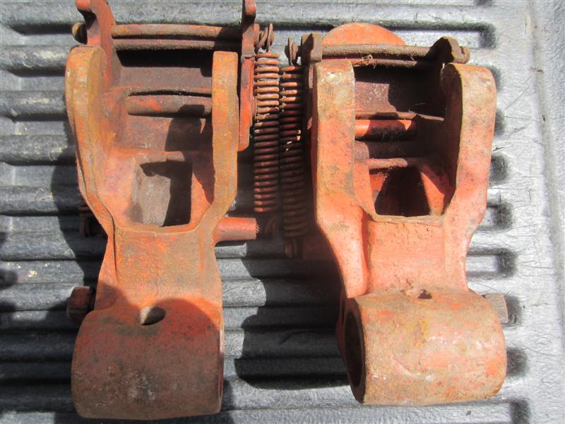

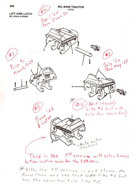

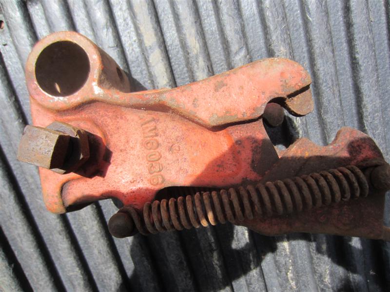

Post Options Post Options   Thanks (0) Thanks(0)   Quote Brian G.  NY Quote  Post ReplyReply Direct Link To This Post Posted: 31 Oct 2017 at 9:26am
I did a little research on this issue a few years ago.
This is what I found out.....I think I got it right!
As stated, the CA, D-10, etc use a different style coupler.
The 3 photos show what I think are the latest and heaviest latches;
probably for the 175 and up tractors altho they should fit the WD-WD-45s as well.
The last photo shows a comparison and the extra "meat" in the casting of the HD unit.

Post Options Post Options   Thanks (0) Thanks(0)   Quote TedBuiskerN.IL. Quote  Post ReplyReply Direct Link To This Post Posted: 13 Dec 2021 at 10:04am
The D17 would probably have used the #4 lighter couplers with the spreader bar.  I would imagine the #5 came out about 61 with the D19, a heavier tractor, and was carried through to the snap coupler versions of the 190.  JMO.
