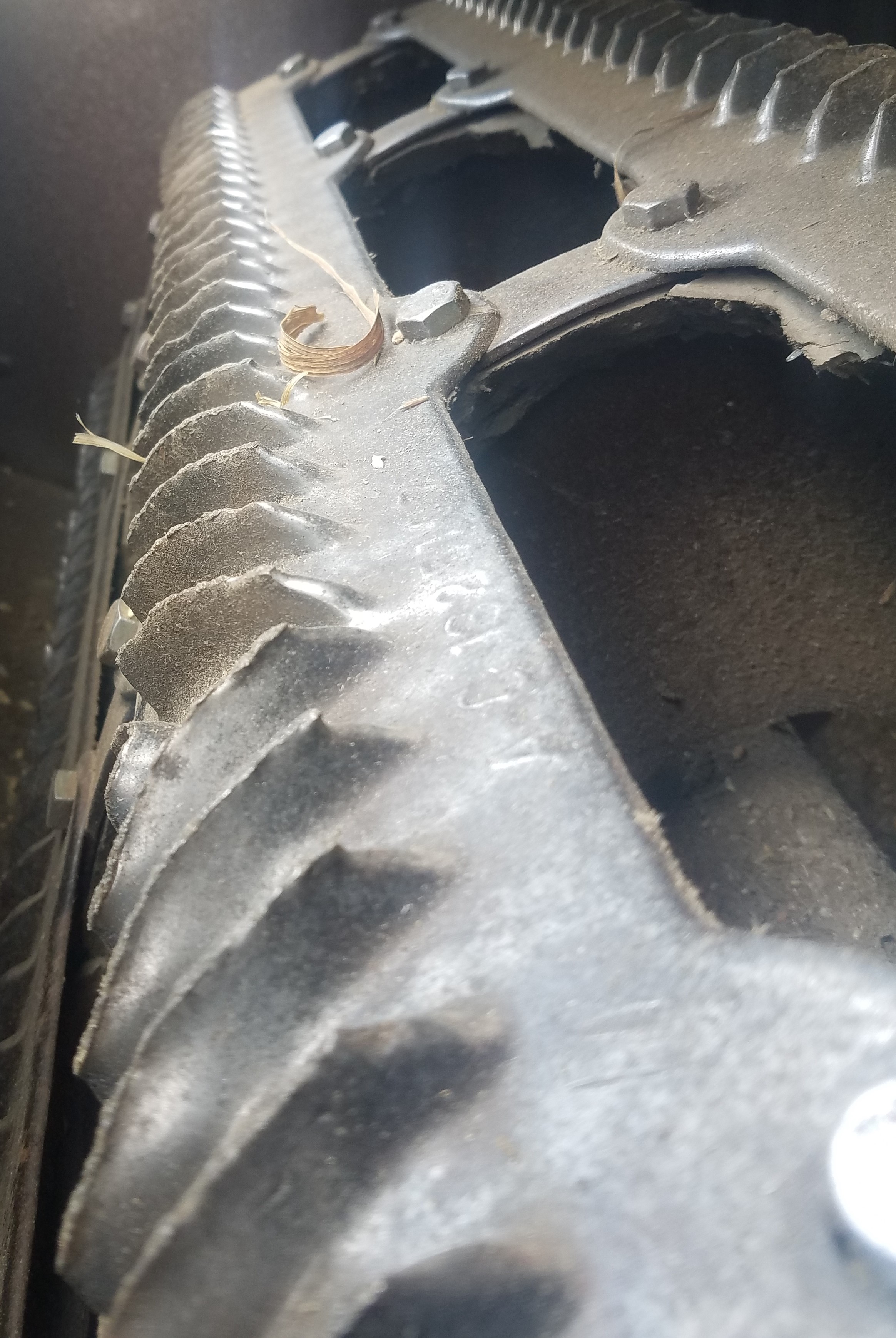

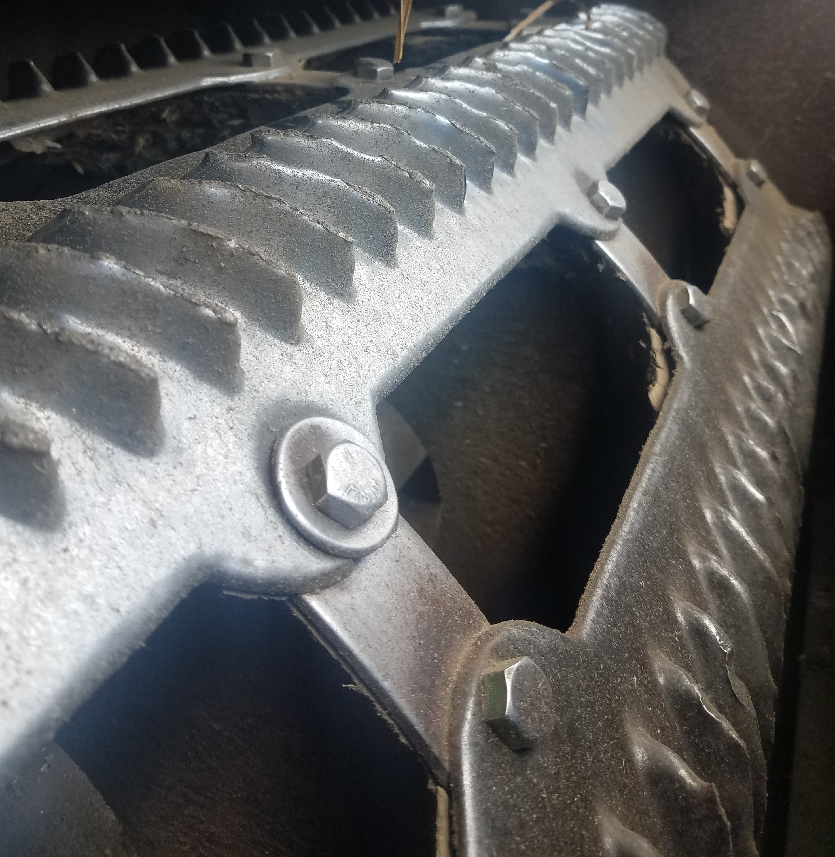

I am wondering what you guys think of these bars, are they good? need replaced? I think the combine has noticeably lost capacity. A couple of years ago we turned the bars but I dont feel like it helped any (I think they had been turned before).  Are leading the edges supposed to be straight up and down? Should the teeth be square?
In the 1st picture the left side is leading now
2nd picture the right side is leading now

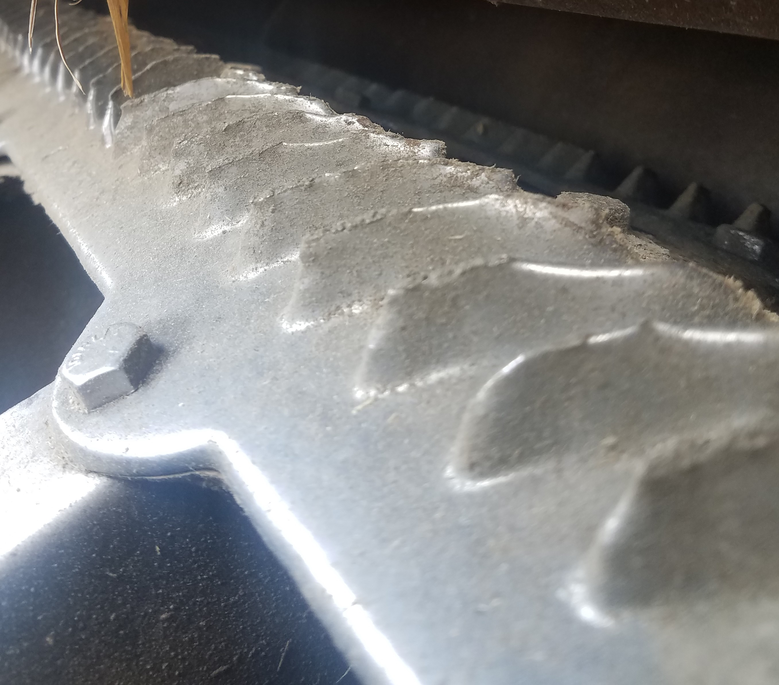

In the 3rd picture you can see the hooked teeth on the trailing side

Replace.

They must have been hard surfaced judging by the hook on the worn side and the rough look. They look a little beat but by my eye.... and I'm no expert.... the leading edge doesn't look bad..... some teeth look smoothed over on the lead edge but 99% look OK to me. What are you threshing? What little I know is dealing with corn and soybeans not wheat and not much with oats.

They look like worn out Trimpe hard surfaced ones to me and that top pic looks like center of teeth have hd surf  worn away. Look too far gone to re weld. Trimpe in Seymour IN will be your most economical replacement.

Those bars are shot

If you take the time to grind front edge square , they will be better than most bars you can buy today .          MACK

Those bars look like chrome bars. Replace. You will save money in the long run on fuel.

Thanks for all the replies, we are getting a rebuilt set from Trimpe.
