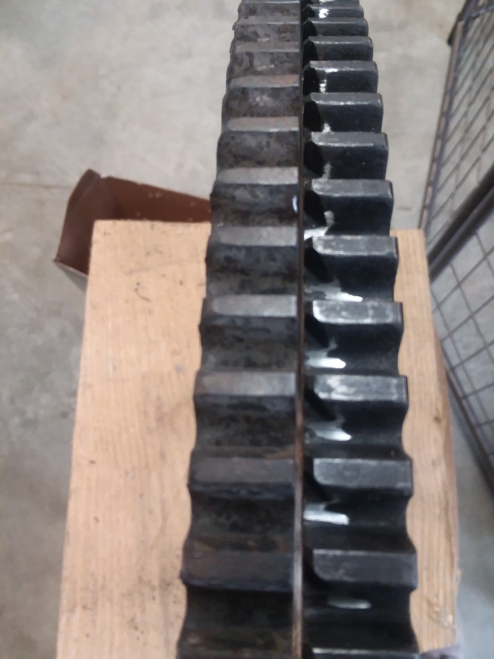

Post Options Post Options   Thanks (0) Thanks(0)   Quote marzer Quote  Post ReplyReply Direct Link To This Post Posted: 18 Nov 2019 at 6:49am
Back from the dead...
I finally got to the bottom
of my starter problem. The ring gear didn't have the lead edge machined. I changed the ring gear and no more clash. Only took twenty years. Wonder if it was under warranty...

Never seen one that didn't have the edges cut. Guess there's plenty I've not seen!
You could spend and hour with a grinding wheel and "fix" the old one.

The new ring gear was $80 from the Agco dealer. Cheap fix as far as I'm concerned. Wish I would have changed it the last time I had it off twenty years ago.
