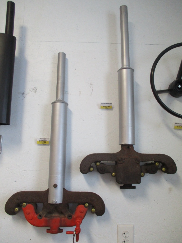

Just saw a post on the FB allis group about late D17 Nelsons and the WC/WD style nelsons being available and immediately thought of this topic.
Kind of stoked to have the original WD available, as one of mine has the WD-45 manifold (and I have a Nelson for it), but now I can get a Nelson for my older manifold and get rid of my crappy third stanley.
Nelson mufflers for the WD/WD45 and early D17 have always been available through AGCO.  Both of my WD45s have them and sound right.
garden guy was talking about me having the original WC/WD style muffler (219534) available, as well as the WD45/d17 style muffler (229531). The older WD/WC one has a longer outlet and mounts different. Both have the rain skirt, but 229531 has the rain skirt extended for the mounting holes.

Alex, will this D17 III / IV Nelson Fit a One Seventy? I might buy a second one if it does. Already bought one for the D17 and love it.
Points: 22757
Post Options Post Options   Thanks (0) Thanks(0)   Quote DrAllis Quote  Post ReplyReply Direct Link To This Post Posted: 22 Nov 2020 at 6:46pm
Will fit a 170/175 but not original. The 170/175 has a longer/taller and slightly larger diameter tail pipe.

What was the reason for the larger outlet? Aren't they virtually the same engine and HP as the D17?
Points: 22757
Post Options Post Options   Thanks (0) Thanks(0)   Quote DrAllis Quote  Post ReplyReply Direct Link To This Post Posted: 22 Nov 2020 at 8:41pm
170 is about 4 more engine HP at is rated at 1800 RPM's instead of 1650 RPM's. Larger diameter tailpipe means freer flowing exhaust. Taller tailpipe reduces engine noise at the drivers ears.
Dr. Allis is spot on, bigger opening (1 5/8 vs 1 7/8") for faster gas flow. And if I may ad the 100 series were offered with ROPS & canopies so the taller outlet may have been to help exhaust clear the canopy. FYI, it looks like the 170/175 gas muffler will come in somewhere in the $16X range.

Would these gas 170-175 mufflers work on late series 17 diesels, by chance?
The 170/175 mufflers won't work for D series diesels. I can't remember exactly the dimensions we measured off your diesel, but I think the oval body is 4"x7". And the 100 series and gas ovals are 9"x4.25" so they won't fit in the hole in the hood.
